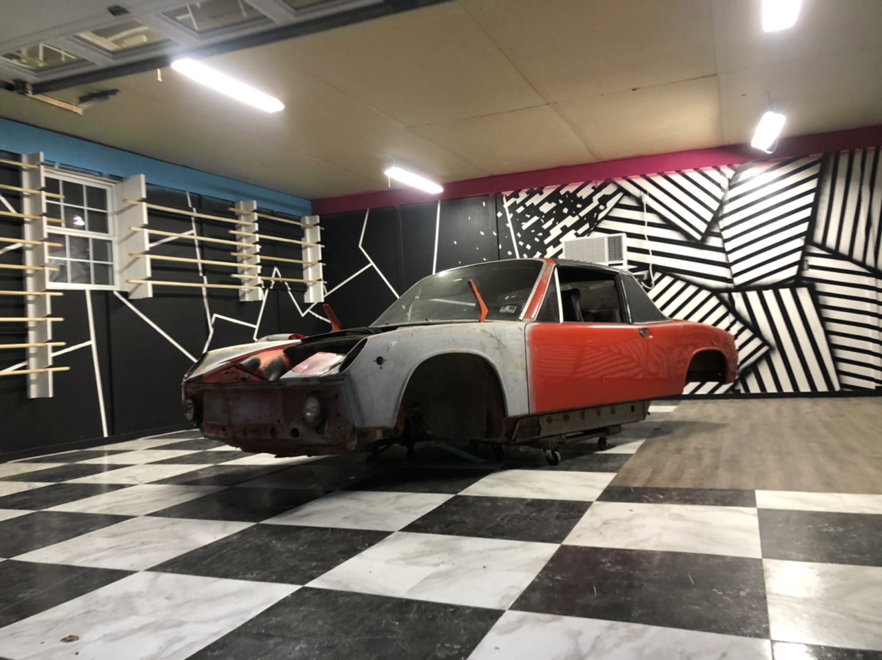

Quick update: i picked up my doner car today! I put it in my nee trendy looking shop (IMG:style_emoticons/default/biggrin.gif) Attached Image

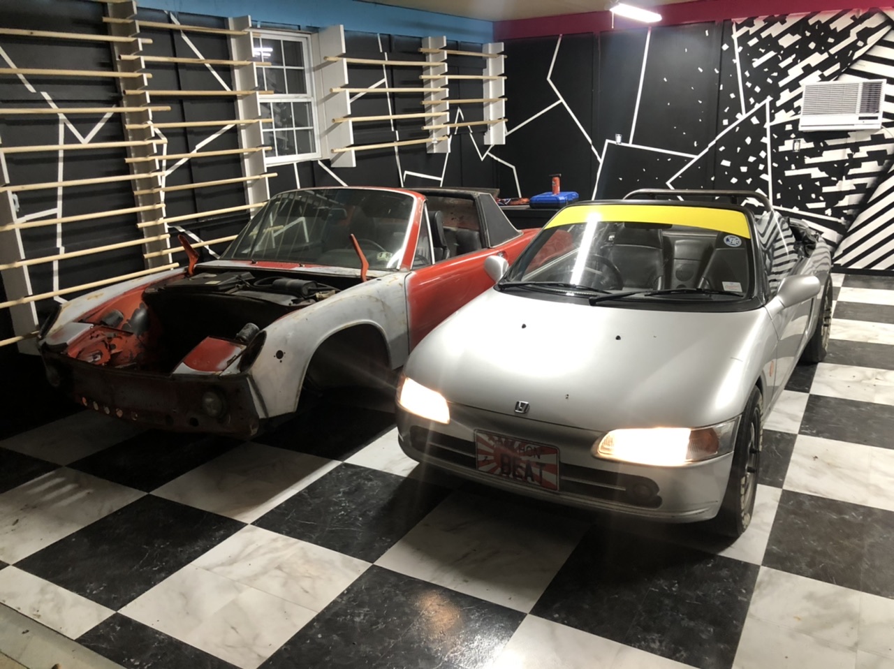

And next to my daily driver
