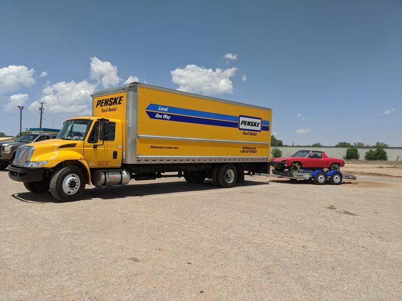

Car made it safely to San Antonio. Only passed one other 914 on the 2000 mile trip (on a trailer as well!). Will be awhile before I get time to finish it, panels are on but not aligned and it has a lot of small details to finish.
(IMG:http://www.914world.com/bbs2/uploads_offsite/i.imgur.com-23821-1591204339.1.jpg)
