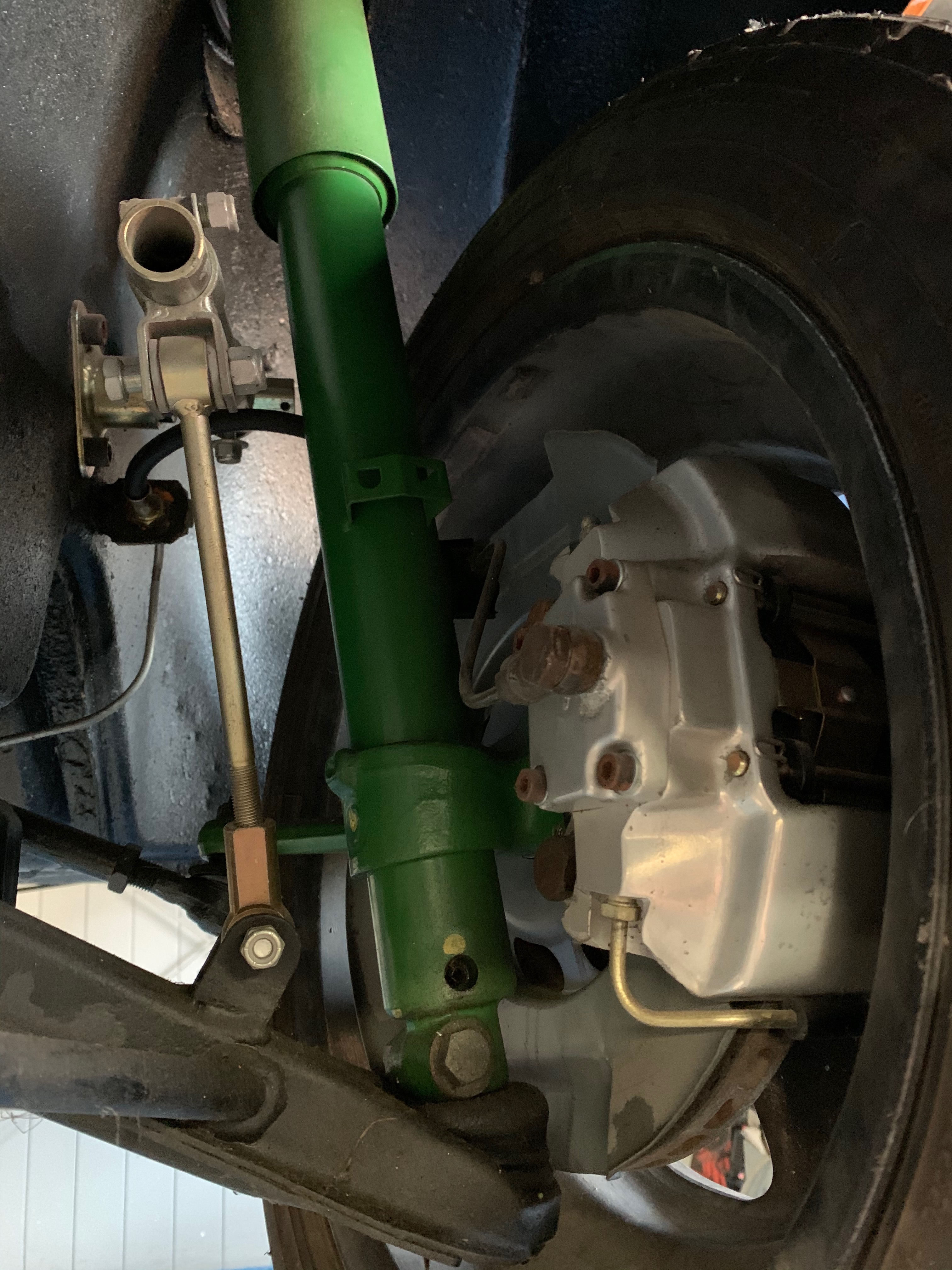

roblav1   I just put this setup on my car yesterday: - Carr...   Nov 1 2019, 08:01 PM
roblav1   I've got the same setup with Boxster calipers ...   Jun 10 2020, 09:27 AM
