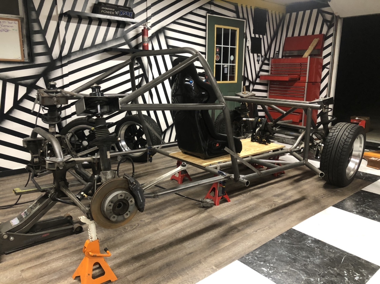

tazz9924   Quick update: i picked up my doner car today! ...   Jun 3 2020, 06:35 AM
tazz9924   A lot of progress! ill be brief because im tir...   Jun 21 2020, 07:55 PM
bkrantz   I get dizzy looking at the tubing angles in front ...   Jun 21 2020, 09:37 PM
tazz9924   I get dizzy looking at the tubing angles in front...   Jun 22 2020, 12:13 PM

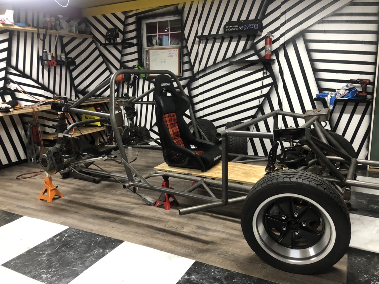

tazz9924   Its a roller kinda! I added a strut bar on the...   Jun 22 2020, 09:16 PM
Carbon-14   Observations from afar, looking forward to the 91...   Jun 23 2020, 04:20 AM
tazz9924   Observations from afar, looking forward to the 9...   Jun 23 2020, 06:13 AM
