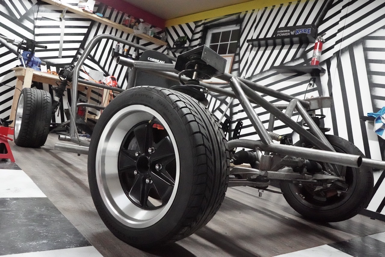

Its a roller kinda! I added a strut bar on the back and let the jack rip. Unfortunately i still need to “mount” the subframe. At the very least better, because as it rolls its held by hopes and dreams. But hey its celebration time (IMG:style_emoticons/default/cheer.gif)
Two of the bars are temporary that are on the subframe btw.

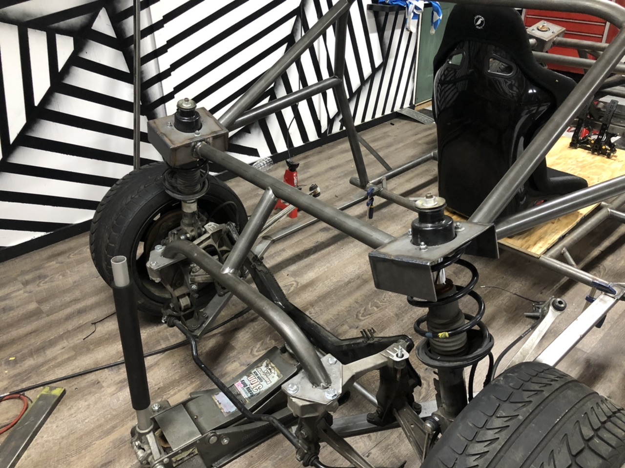

tazz9924   Made my strut tops! Ill be honest i was very e...   May 13 2020, 09:56 PM
