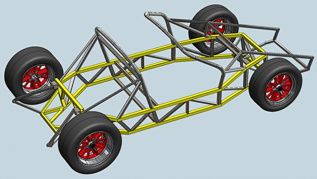

Heres the quick break down: My old car got totaled on the side of the road, i got a good settlement out of it and with the money im building A tube frame chassis 914 with Porsche Boxster suspension and a subaru turbo motor.
The goals:
(Disclaimer some of these are really down the road and may not make the initial version 2.0, maybe 2.1 or so on and so forth. They are also goals so weather or not i achieve them, it’s something to shoot for.)
Tube frame chassis, all made of DOM tube and when all when the car is fully built it should weigh 1600 ish lbs.
The motor: It will have a subaru turbo motor. The initial version will see a 2.0 just so i can start having fun but eventually it’ll be a hybrid 2.5 making 400whp
The suspension: It will all be porsche boxster same with the brakes so it should handle all the power and lack of weight im throwing at it.
The body: It will be all fiberglass panels dzused on with the exception of the A pillar which will be a stock piece from a 914 but it will retain a vin tag. The only other stock 914 related thing will be pop up headlights which will be retained.
Aero: This thing will have an extreme aero package. From the smooth underbelly with large rear diffuser and front splitter to canards and a chassis mounted rear wing, This “car” WILL have a presence like little else.
Interior: Skip... JK this thing will have a digital dash, k tuned shifter, willwood pedal cluster, and a plaid racing seat. Thats about it, passenger seat is seen as optional at this point.
So hopefully this should be good, i dont have much time, even in the covid 19 world we currently find ourselves in right now. It may not be a fast paced build but the goal is to have a roller by june... So lets get to building!

Observations from afar,
looking forward to the 914 skins, suitably modified to be sleek, a stiff chassis to allow competitive performance.
Subaru power, should go, like.
SolidWorks or a similar cad sw.
Basically, a GT40 replica's tube chassis, modelled in balsa, or Z88 fea, to plan the performance and weight.
