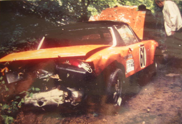

here's another interesting GT pic, don't know if that has already been posted ...
"Marathon de la Route, 1970"
Car #: 61
Drivers: Walter Simonis (D), Horst Hoier (D), Ulf Kayser (D)
Rank: DNF
Engine cc: 1991
Engine Type: B6
Group: GT
