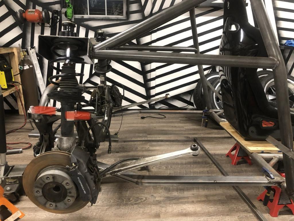

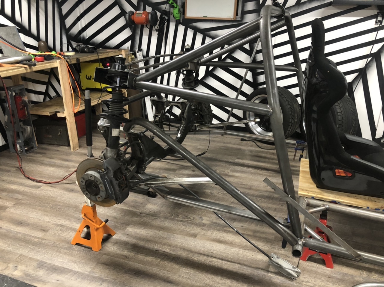

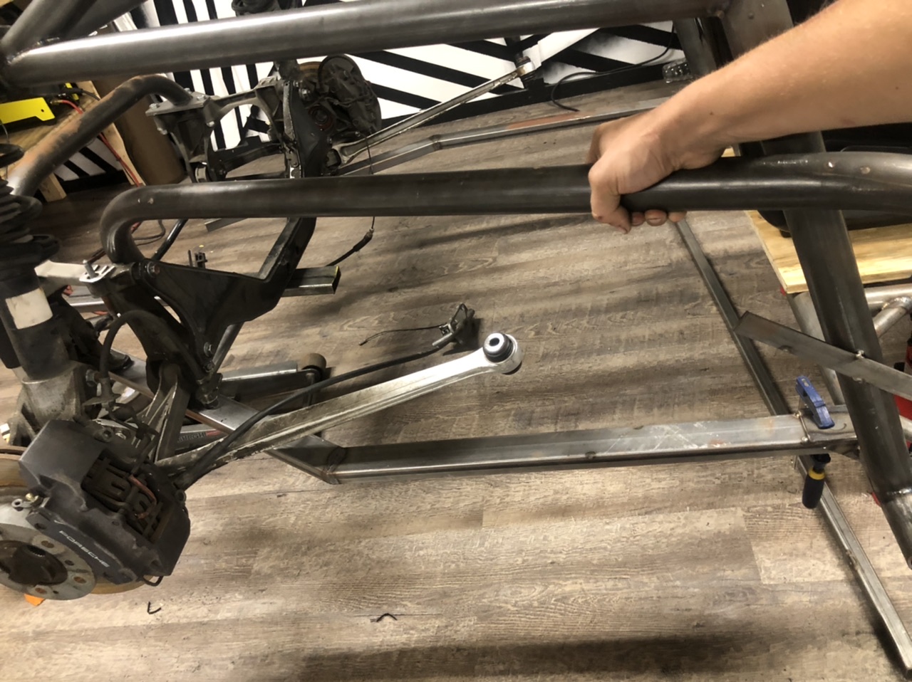

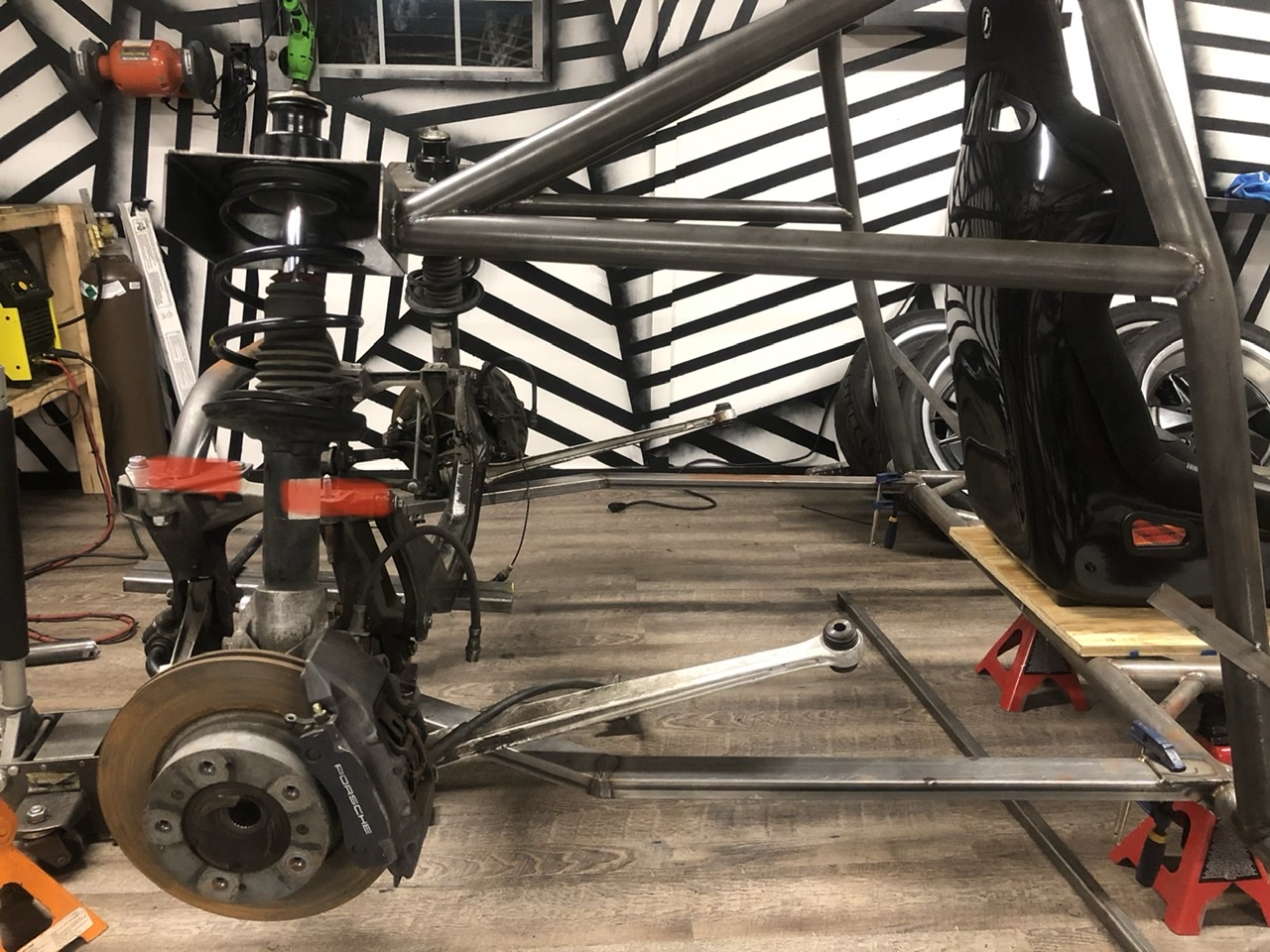

Ill admit im a little stumped... Call it: i want to make the best decision but require the input of others to feel comfortable. So i need to mount the rear subframe but unlike most of the stages so far this to me seems less obvious. My big issue is how to best mount it when the mounting plate is 90 degrees to the direction my bars are coming at. Heres a picture of what im dealing with: (the red highlights are the subframes mounting spots)

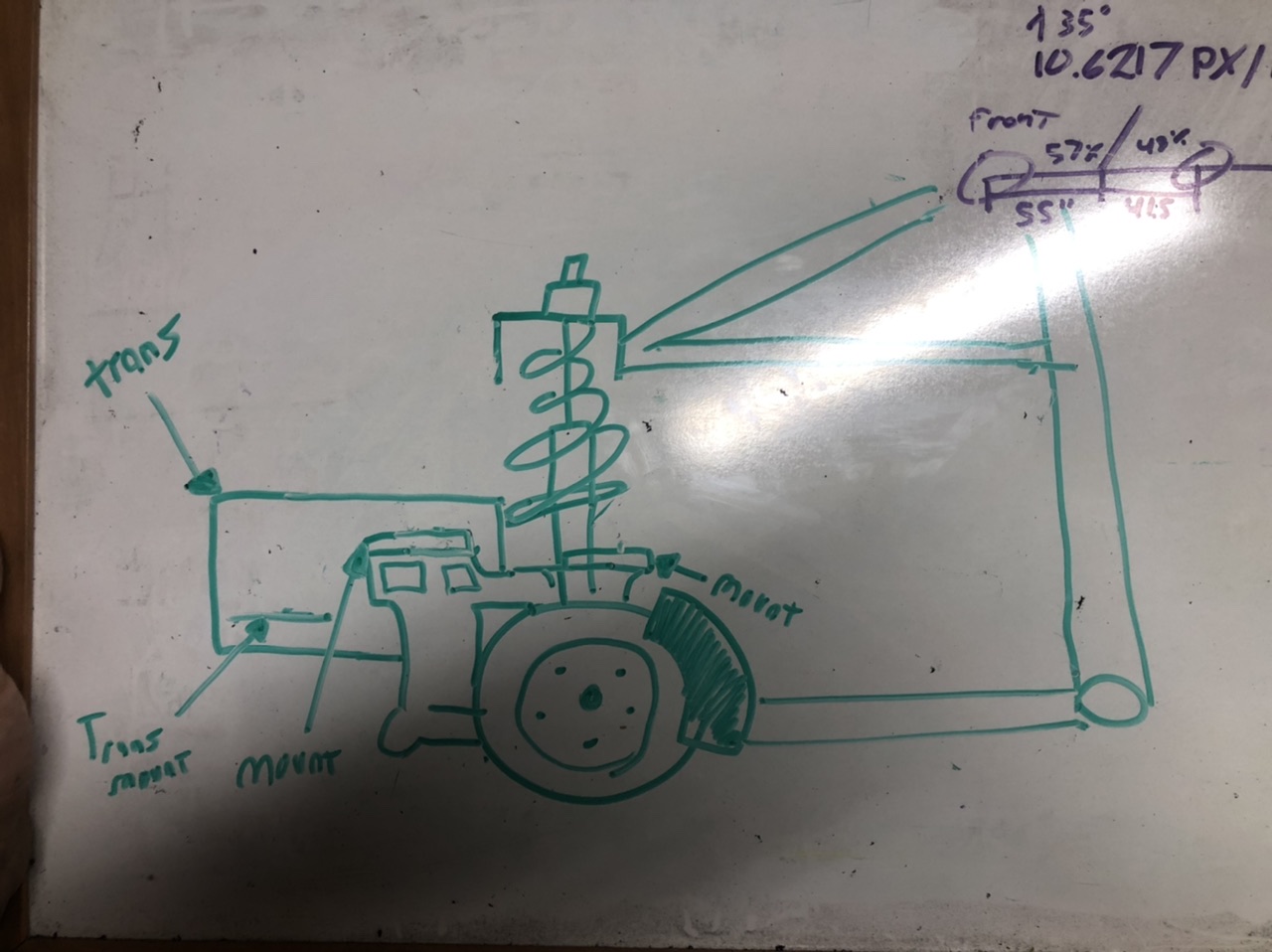

I also have a nifty drawing showing where the trans will sorta sit when its on:
My initial reaction is to add a bent tube meeting up with the bottom of the main hoop and some tubes linking the bar above it with the bent tube shown:
Alternatively i could add a tube with just a 90 bend in it meeting up maybe 6 inches lower than the parallel bar above it kinda like this with some more reinforcement tubes:
This is my dilema, any input is appreciated. Even just linking someone engineeringly minded would help my cause!
@Carbon-14 ?
