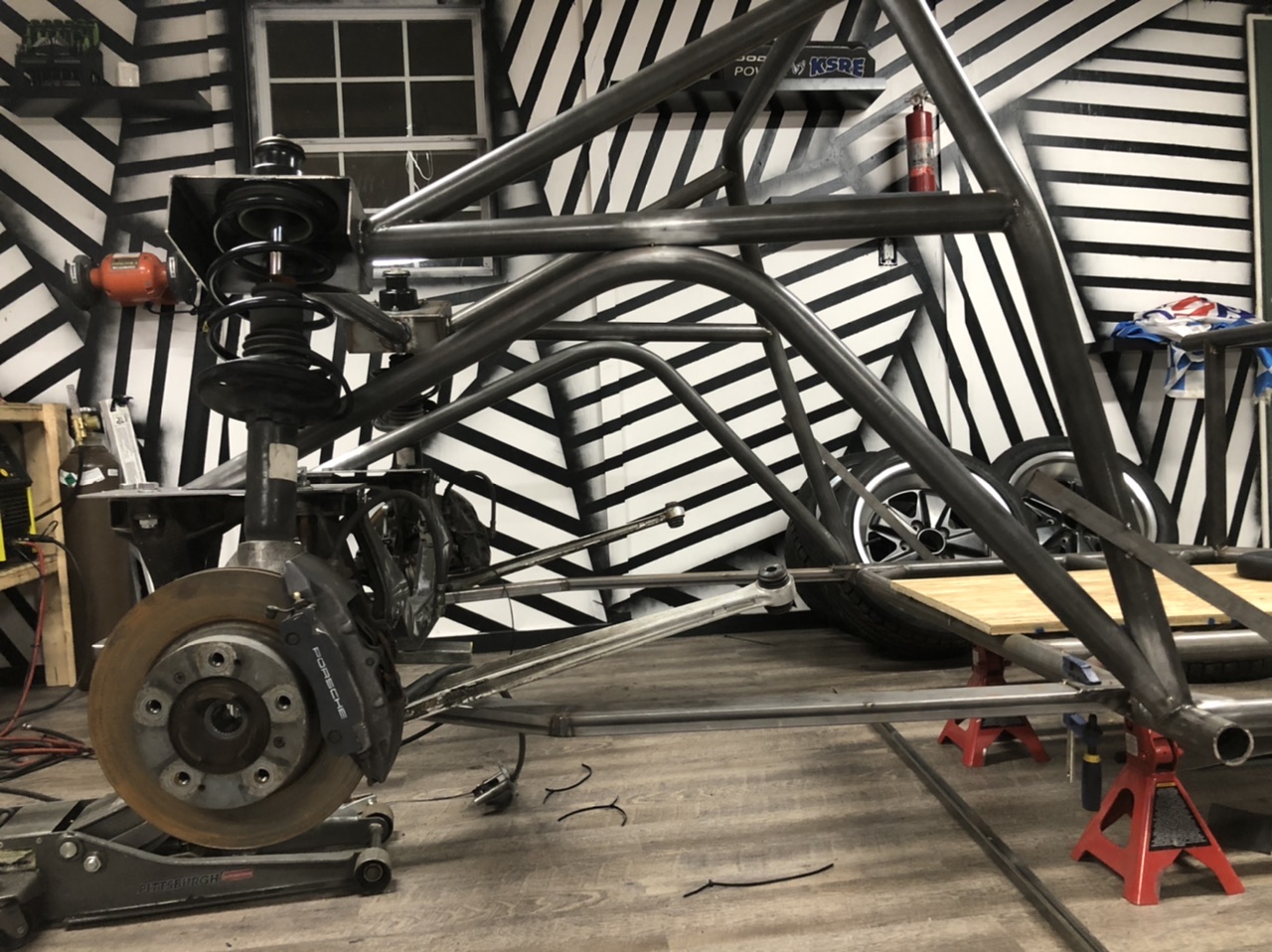

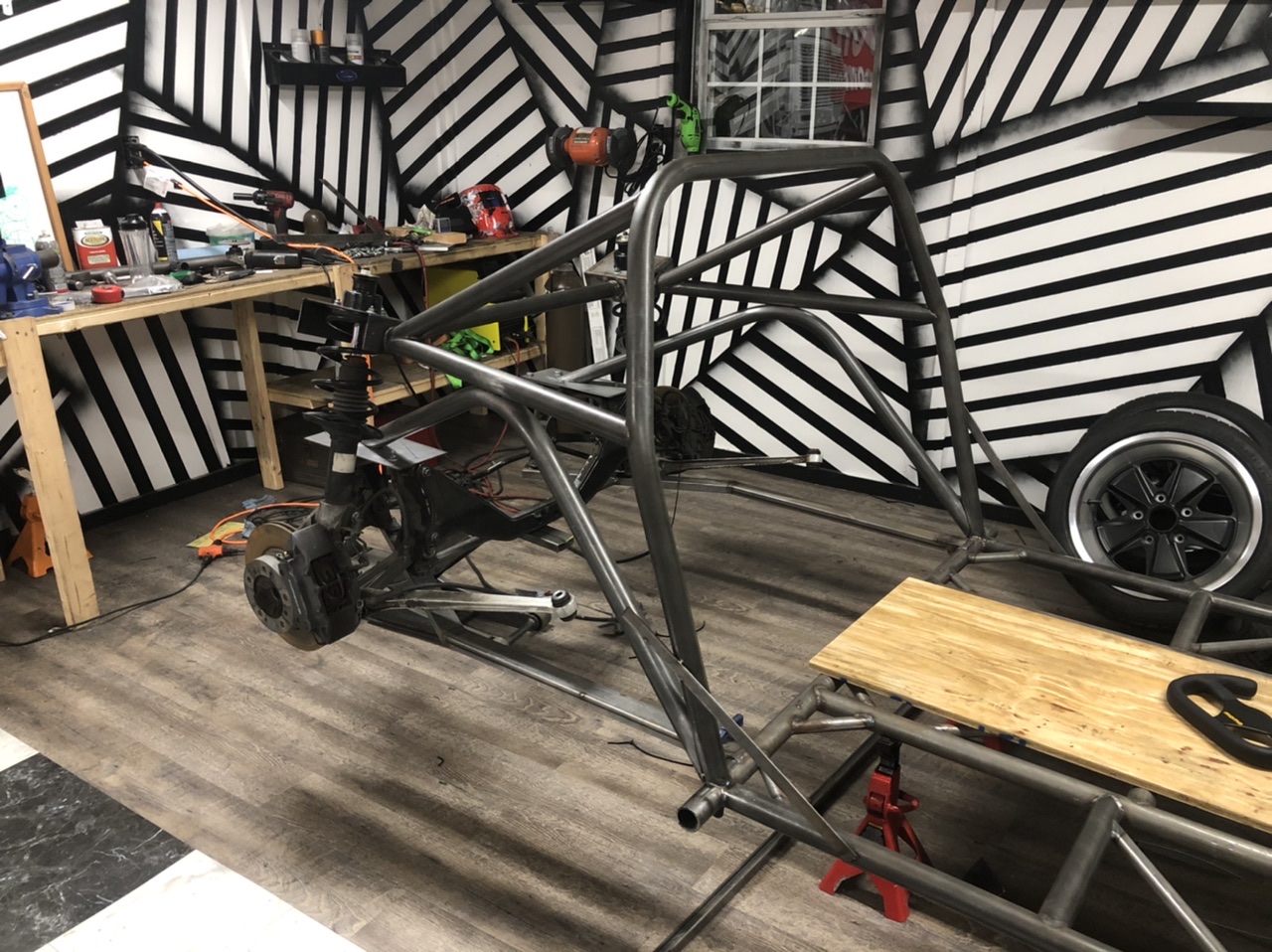

tazz9924   A lot of progress! ill be brief because im tir...   Jun 21 2020, 07:55 PM
bkrantz   I get dizzy looking at the tubing angles in front ...   Jun 21 2020, 09:37 PM
tazz9924   I get dizzy looking at the tubing angles in front...   Jun 22 2020, 12:13 PM

tazz9924   Its a roller kinda! I added a strut bar on the...   Jun 22 2020, 09:16 PM
