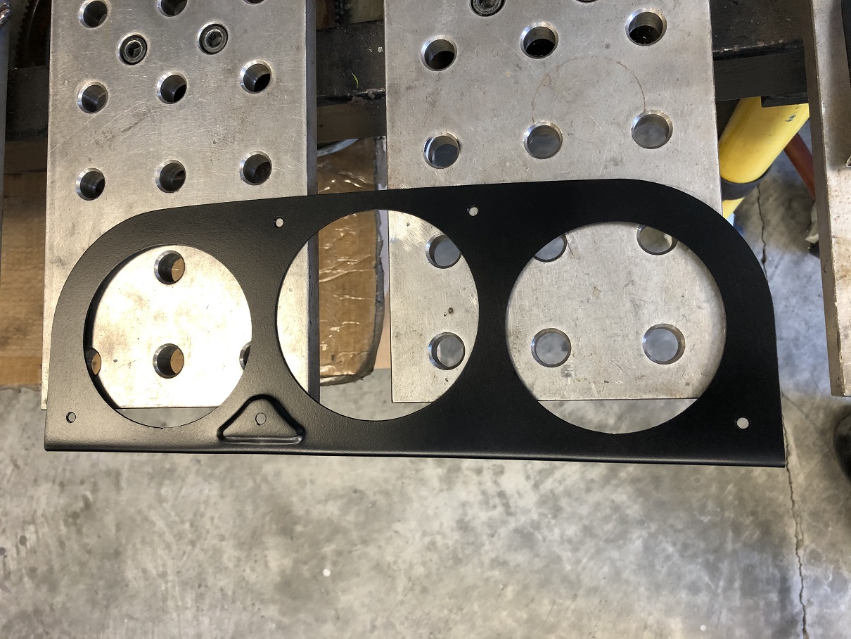

I made 6 SpeedHut gauge panels today. See my post on page 4 of this thread for a "fresh off the plasma table" pic.
If you're still interested, I should have these ready to go in a week or so.
- these are .063 3003 aluminum
- they will not be painted
- they do not have the raised stamping for the dimmer
- they are set up for a 4.5" center gauge, 4" outer gauges
- 3 have holes for the dimmer, 3 don't
$35 plus shipping from 94952.
Yes, I'd said $20 earlier but that was a year ago and I was being too generous with my time and consumables. Just be thankful I'm not making them out of wood. (IMG:style_emoticons/default/laugh.gif)
Let me know if you're interested. I'll probably make more once I get more material.
Thanks again for your patience.
Chris

For those using or contemplating SpeedHut gauges, you'll find they are just a bit undersized compared to the stock gauges and require some sort of wrapping or spacer in order to fit well in the stock panel.
I opted to give a go to working up a replacement panel and as I was making it, I thought, while I'm cutting one, I could cut a few more, if there was interest.
This is V1 and it needs a couple minor tweaks, but you get the idea.
Note that it has a 90 degree fold along the bottom edge that I'll stretch so the panel curves a bit, like the factory part.
This one is .060 aluminum but I could do steel, too.
Would anyone be interested in one?
PM me, thanks,
Chris

A trip to the stretcher to get the needed curve so it sits nicely against the dash frame, a lick of paint and:
I tried to get the pic to really show the dimmer stamp area.
I think I can live with this version.
Hope you enjoyed the details about how I make these panels.
