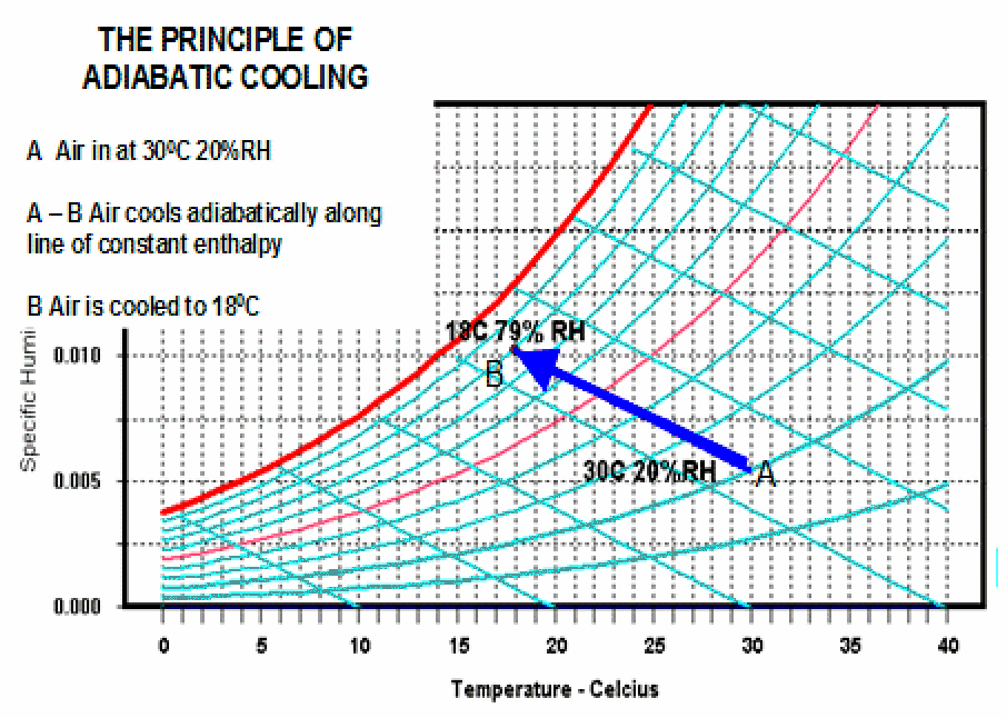

Not your typical HVAC system
' Swamp Coolers ' or, more accurately,
' automotive evaporative adiabatic air conditioner ' : an electrical load on system, carrying a few gallons of water, filled regularly in summer, most useful in dry, hot conditions.
Works on chilling air-cooled engines too !
