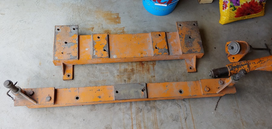

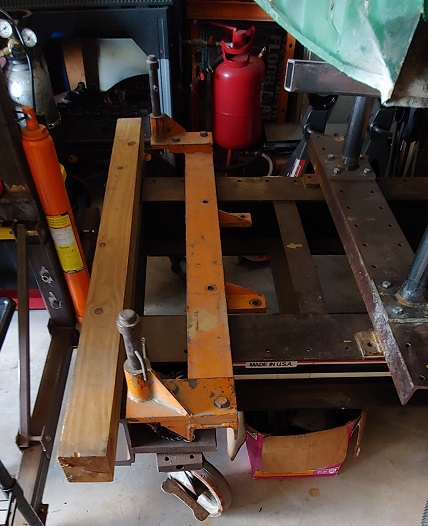

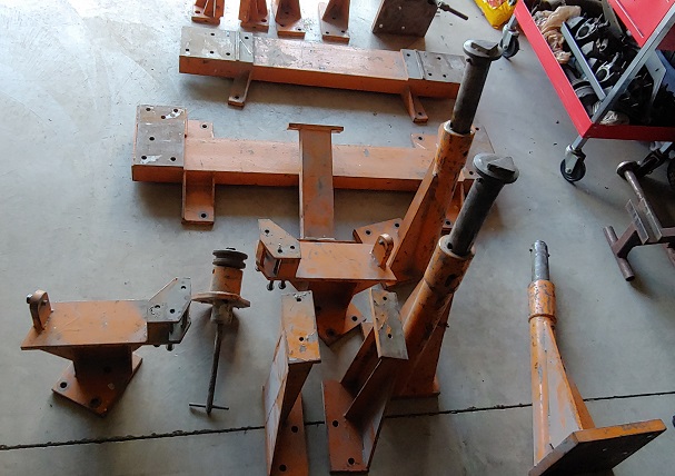

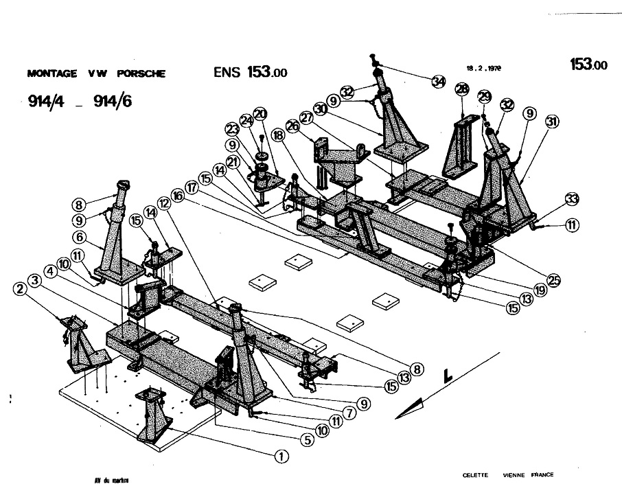

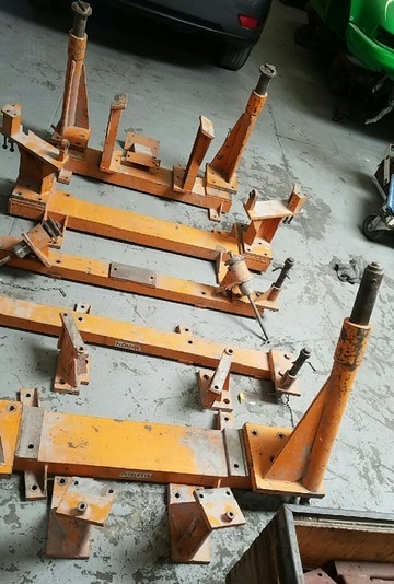

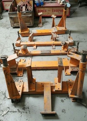

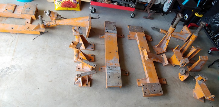

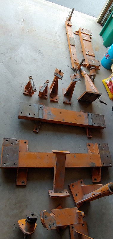

Well after months of waiting (thanks to covid) I finally received my Celette 914 bench fixtures. I'm going to get the 6 off the current fixtures and back on the rotisserie for blasting. Once the blasting is done then it'll be on these Celette fixtures for the chassis repairs.
Attached Image Attached Image Attached Image Attached Image Attached Image Attached Image Attached Image Attached Image

Luke M   Well after months of waiting (thanks to covid) I f...   Jul 14 2020, 05:33 PM
sixnotfour   Well after months of waiting (thanks to covid) I ...   Jul 14 2020, 10:44 PM
rgalla9146   Well after months of waiting (thanks to covid) I ...   Jul 15 2020, 05:25 AM
Luke M   Well after months of waiting (thanks to covid) I...   Jul 15 2020, 07:28 AM

Luke M   Work on mating fixtures to bench..   Jan 23 2021, 08:30 AM
