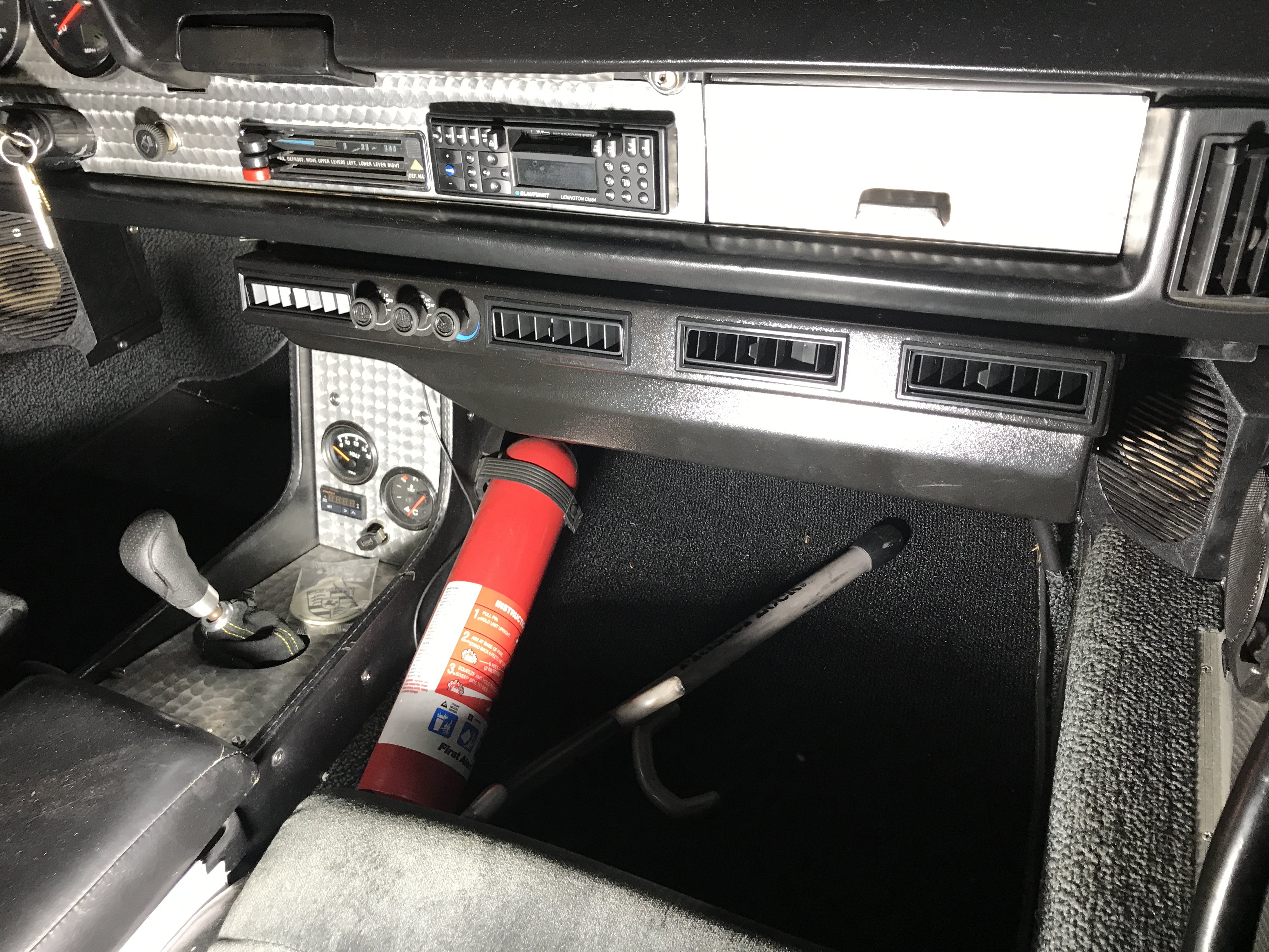

@914forme Sure Stephan. BTW Steve has seen my setup. I went with the Vintage air unit because of the depth of that unit. Everything I found was 12" depth except for this one particular unit they sell that has a 10" depth. Even then it is a close fit. The closer is that you don't need to cut or drill new holes in your lower dash/knee pad. On the right side I bent one of there supplied straight hangers 90 degres. On the left, IIRC I bent another supplied hanger but more of an "L" shape. You use the OEM screws if long enough or a 6mm x 25mm x 1.25. Regardless, it fits the 914 like a glove and does not protrude past the knee pad. I can list the part # but AFAIK it is the only unit the sell with a 10" depth. A little under $500 whenI bought it.
