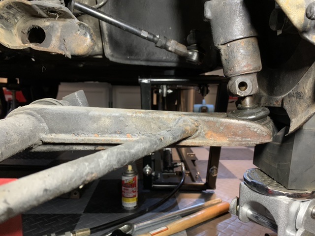

Plan to replace a arm bushings. Started removing the front driver a arm but my ball joint spindle won’t budge from the carrier. Tried tuning fork, map torch, pbblaster, and two opposing BFH. It’s rusted in there. Anybody got alternative strategies? Perhaps I need a special tool although I don’t think the tie rod remover will work here?

I’ve removed at least a dozen pairs from very rusty (east coast) struts. If you still have the rubber cover on your ball joint, you aren’t getting it hot enough. 8-10 minutes with MAP gas, spray with penetrating oil as it cools, hit the bottom of the ball joint with a big hammer to shock it and rinse and repeat.
I always remove the strut from the a arm with the ball joint and then work on the ball joint/strut removal off the car. If you have trouble getting the ball joint nut off the bottom of the a arm, the same removal technique as above and use an impact gun with a good ball joint tool.

Thanks for the pointers! So I was able to pry it loose after a lot of heat, prying, and pbblaster. But just when I thought I was free I got stuck pulling it completely out so I thought by loosening the rest of the bolts and in turn drop the arm out I can wiggle spindle out. Nope. Still stuck. Do I just hammer it out or use more heat and oil?Attached Image
