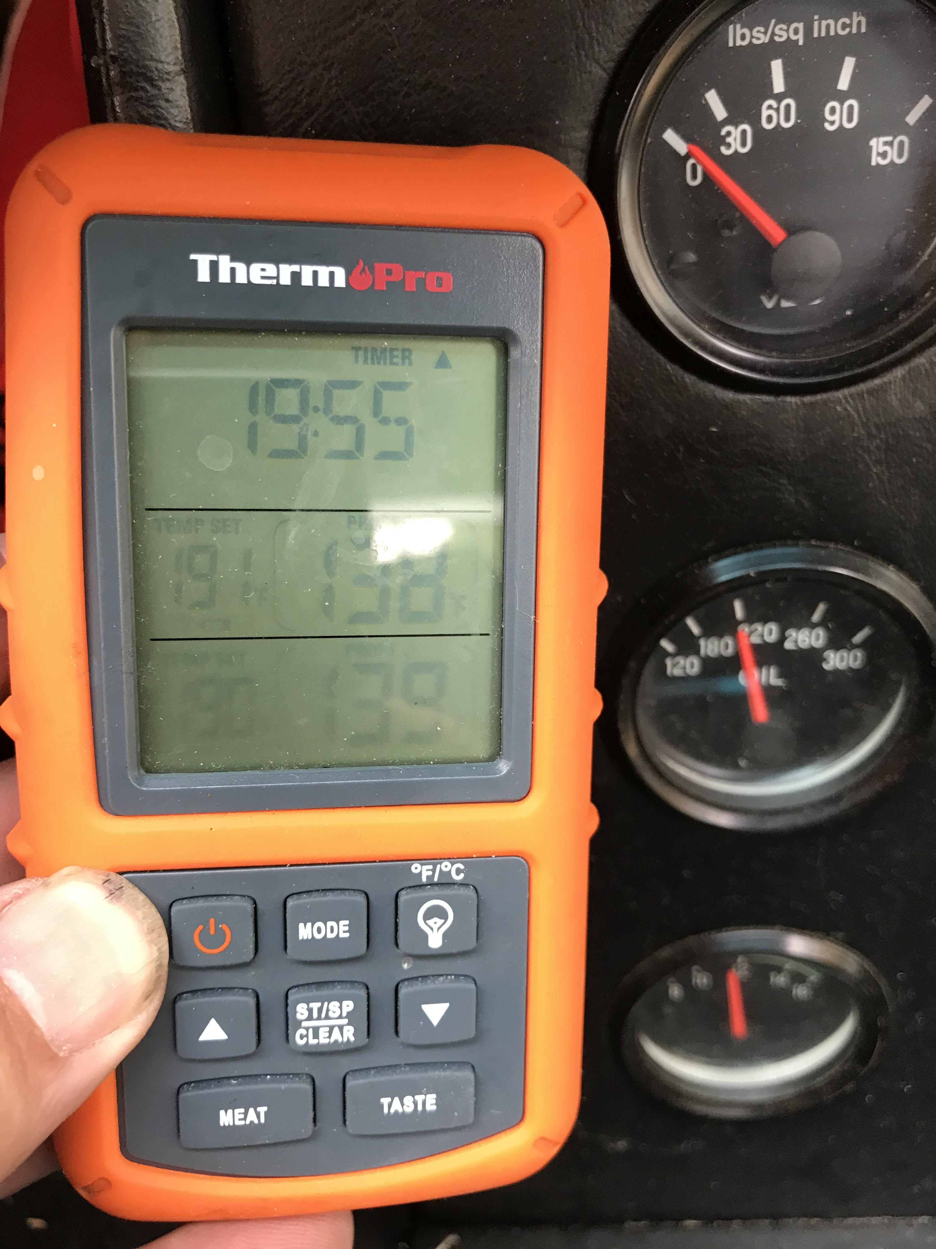

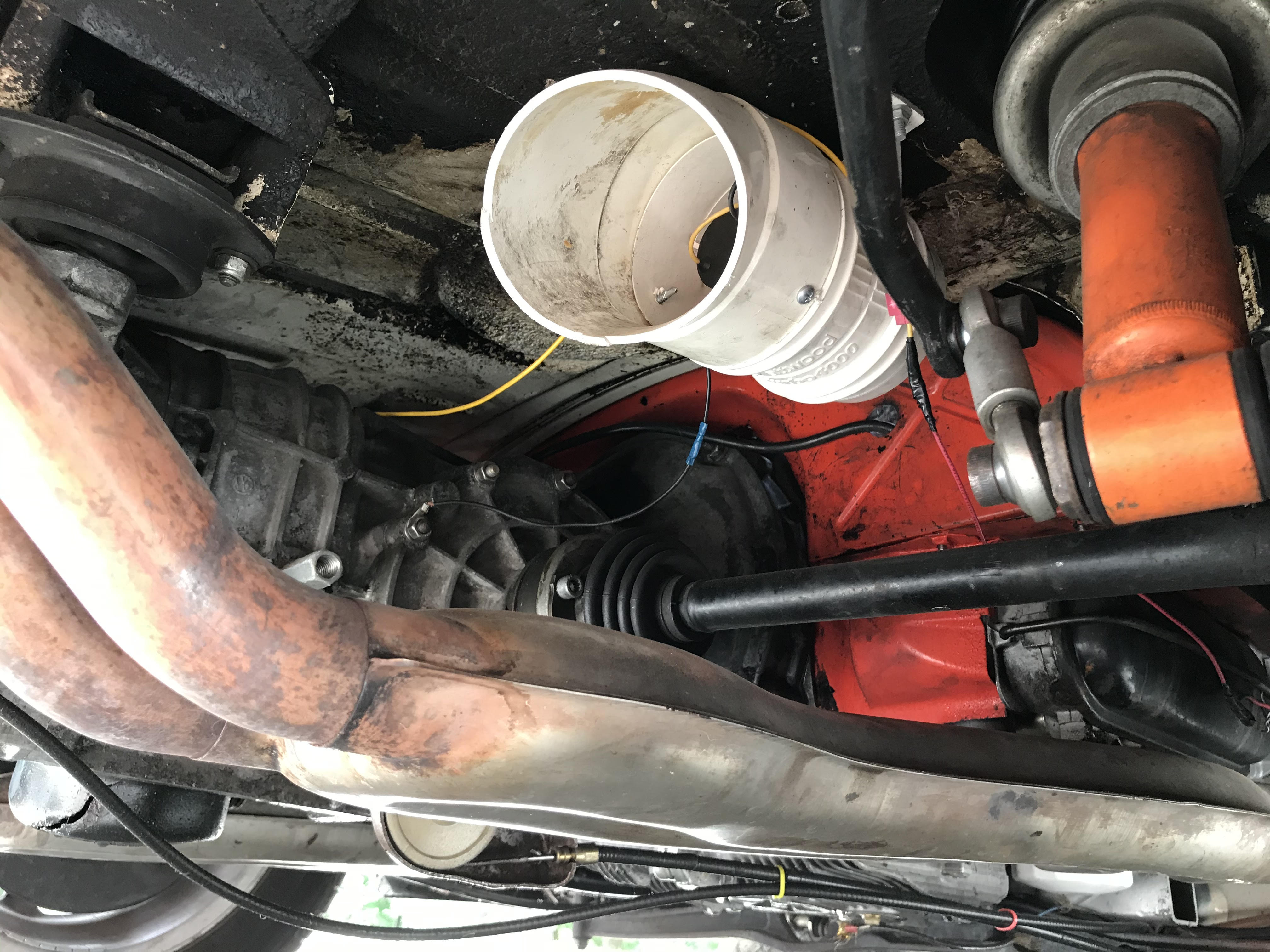

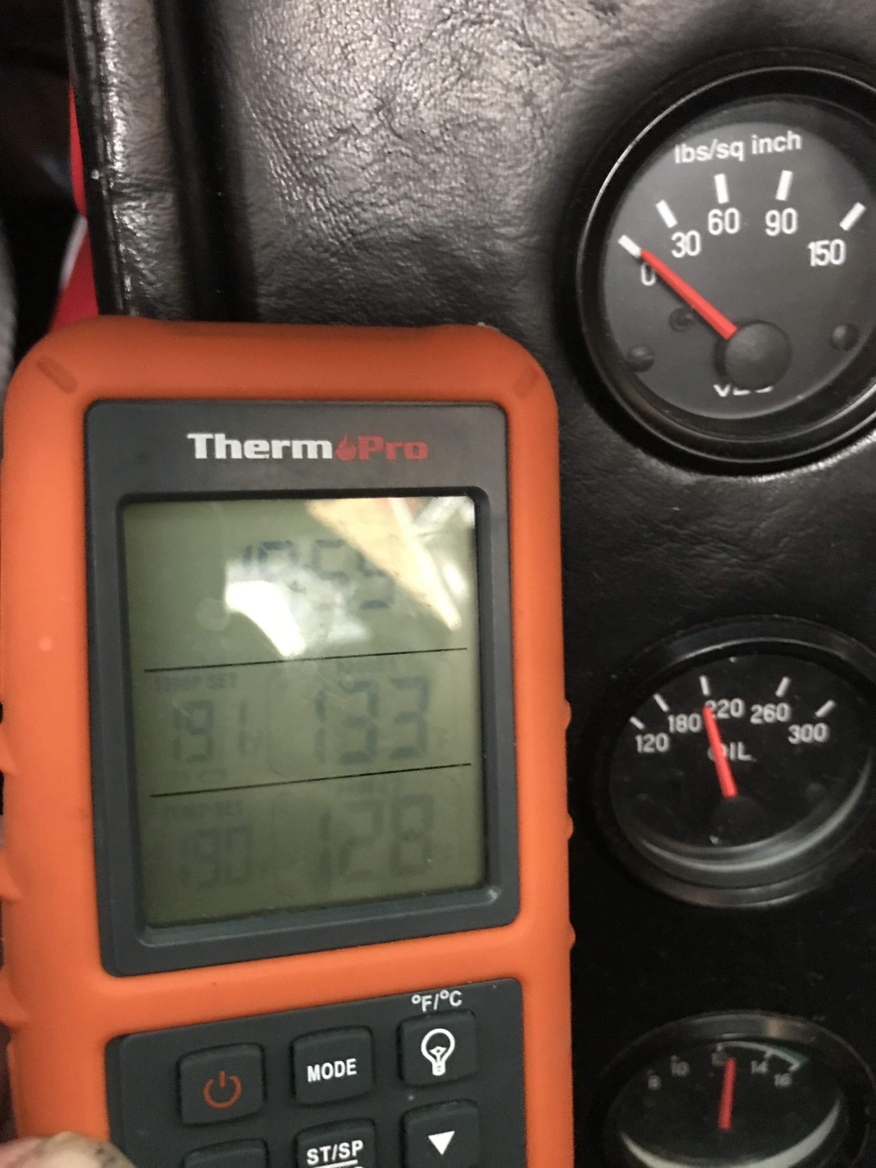

Cooling test under car with and w/out fans, Installed (2) 4" fans under trunk each side of transmission. Oil cooler was not installed for test, oil temp was 220 out side temp 90. Rough numbers fans removed 11 deg under car and no affect on oil temp.
Don't look at oil pressure numbers turned off car to take pictures.
Next test will be with oil cooler installed?? Is 220 oil temp acceptable?
