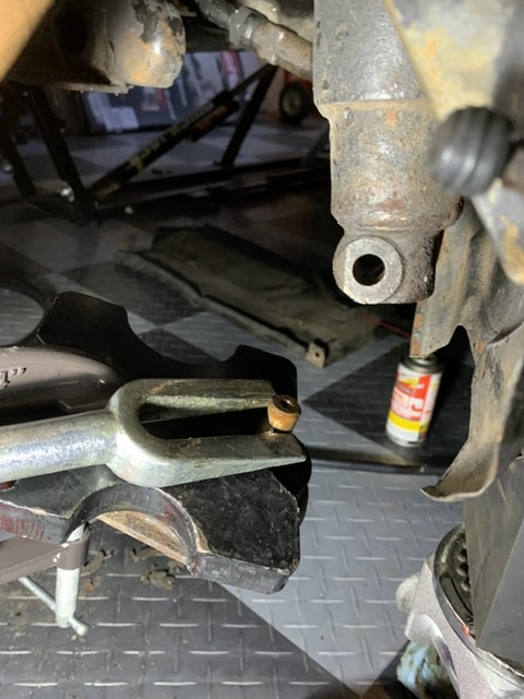

Plan to replace a arm bushings. Started removing the front driver a arm but my ball joint spindle won’t budge from the carrier. Tried tuning fork, map torch, pbblaster, and two opposing BFH. It’s rusted in there. Anybody got alternative strategies? Perhaps I need a special tool although I don’t think the tie rod remover will work here?

I finally got ball joints free. Instead of hammering the arm, I used a block of steel as spacer so I can use the pickle fork. Worked well. Was also able to free the other side same way. It was also seized and rusted but not as bad. Now onto replacing the ball joints and bushings. Thanks everyone!

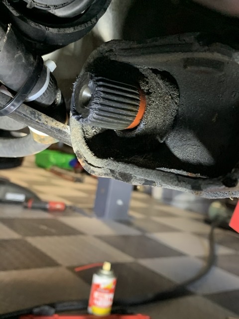

Finally.. quick question.. what the heck is this behind the torsion bar? Disintegrated spacer vs bushing vs washer vs oil/dirt???

mepstein   OEM foam seal. You can buy from Porsche for ~...   Jul 17 2020, 08:40 PM
jonferns   Felt washer/seal. Mine was disintegrated as well, ...   Jul 17 2020, 08:40 PM
Stltri   Interesting. Anybody have a pic or part number? Do...   Jul 17 2020, 10:06 PM
mepstein   Interesting. Anybody have a pic or part number? D...   Jul 18 2020, 05:13 AM
jonferns   Interesting. Anybody have a pic or part number? D...   Jul 18 2020, 09:10 AM
