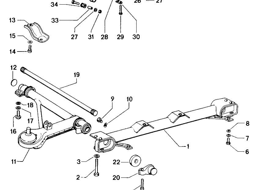

Interesting. Anybody have a pic or part number? Does it simply keep moisture out of the torsion bar space?

QUOTE(Stltri @ Jul 18 2020, 12:06 AM) *
https://nemigaparts.com/cat_spares/pet/pors...14/570u/401000/
#22
