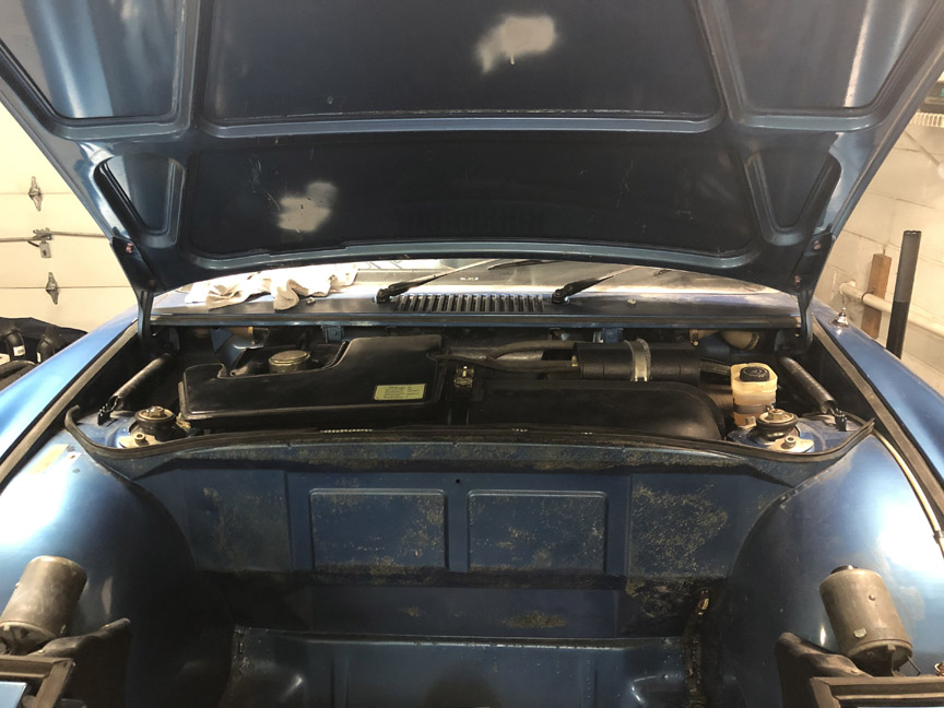

So, the parts I've been waiting for finally arrived. With the new drain hoses for the fresh air box in hand, I was able to get the tank re-installed.

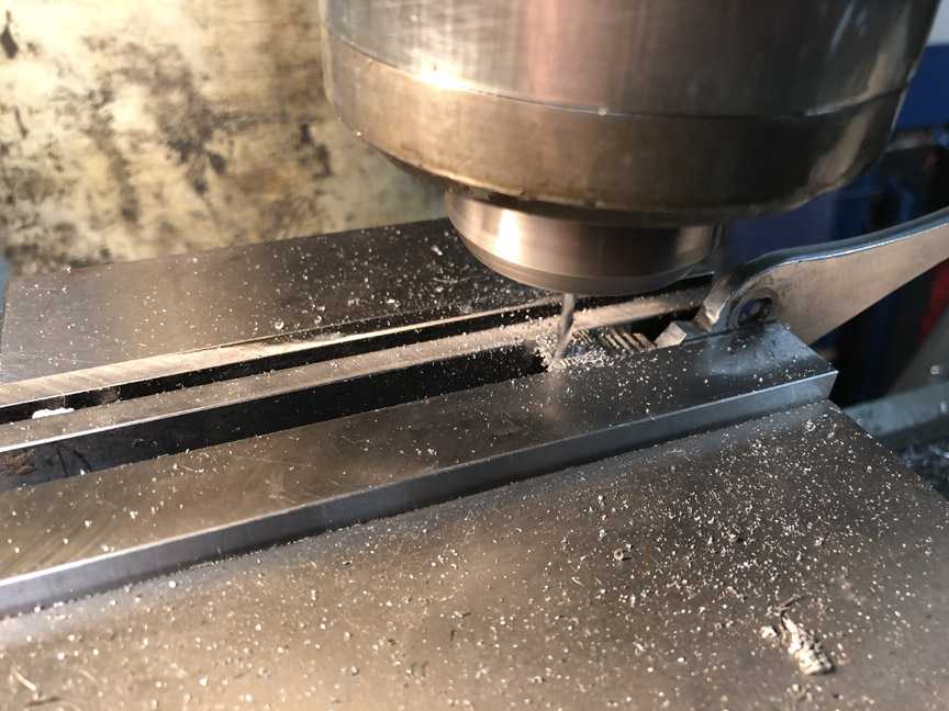

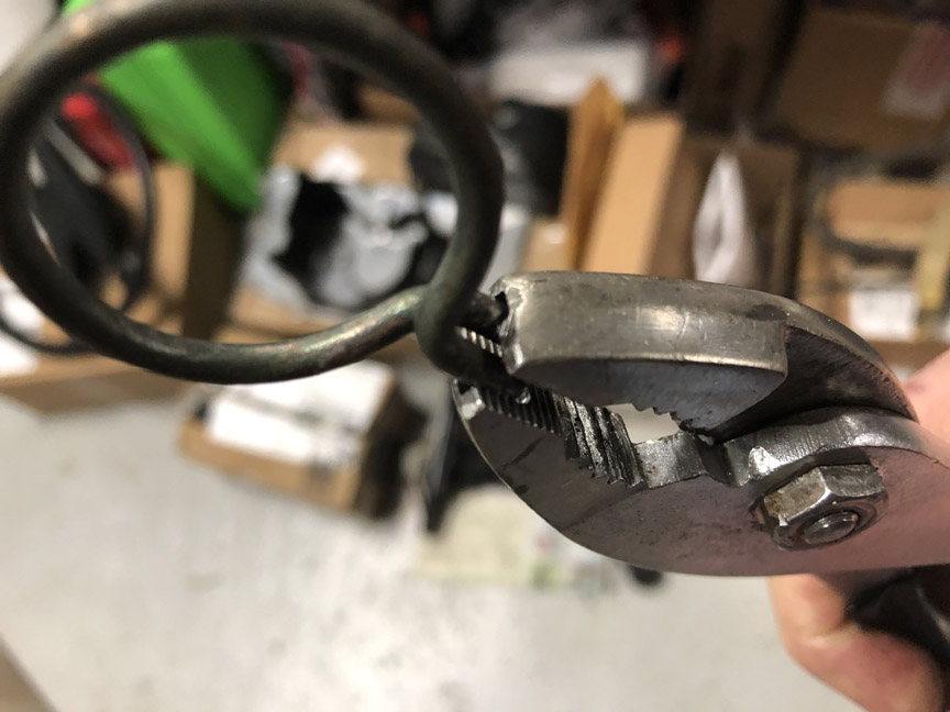

The drain hoses are held in by ring clips, which have quite a bit of force. I wasn't able to hold them open reliably and safely with any of my existing tools, so I modified a pair of pliers to work. First step was to take them apart, then to mill a slot in each half. The slot was offset from the center-line of the jaws so the clip would fit properly.
Here are the pliers reassembled and holding a ring clip. They work very nicely.
And, a shot with the tank installed and everything mounted back onto it.
It looks a little high, but I made sure everything fits under the hood with clearance. I didn't bother with pics of the installation process, since it's a standard tank being installed in a more-or-less standard car. The only real annoyance was getting the rubber side pieces positioned properly, since it was rather finicky to get them at the right height.
