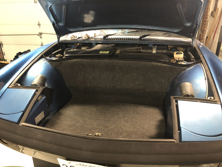

Last night, I glued the perlon back on the front bulkhead and put the spare tire and cover back in place.
I would have ordered new perlon from 914Rubber, but they're on backorder. I'll replace it with a new one at some point, since there's a chunk cut out of this one below the spare tire cover.
