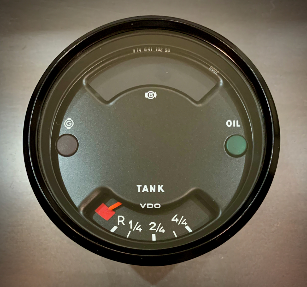

I have a gauge that I got from Slits to use in my street car
I still have not installed it, and its been a few years now
my 1st question:
-what can you tell me about this gauge?
is it 1972 or 1973?
silver dot
so maybe a really early 73 appearance gauge?
I'm not selling this one, just curious and for my own use
2nd questions:
-how do I determine if my current senders, or which senders will be needed.
Currently I have a -6 fuel/oil temp gauge in the dash
its wired to the correct sender in the taco plate
it was 20 years ago... so I'll need to pull the sender to find out which model number it is.
any way I can tell from the numbers/model of gauge which sender is correct to use with this one ?
the fuel side of this "new to me gauge." Its a 914/4 gauge, with a stock 914 fuel tank and sender. I'm betting it is within the correct 90 -0 ohm range since it likely use the stock sender in the fuel tank. How can I verify that, or what do the experts and charts indicate as confirmation?

Hmmm - "B" and other markings look the same as a standard gauge to me. Here's my non-silver-dot version...
