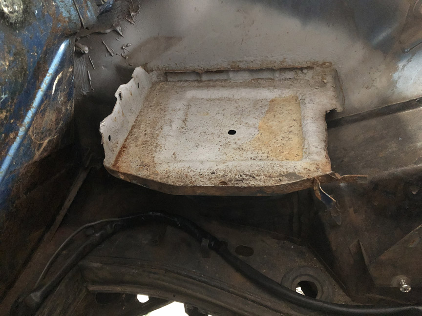

post Jul 26 2020, 10:38 AM
Posts: 761
Joined: 24-April 15
From: Silver Spring, MD
Member No.: 18,667
This is what the battery tray looked like:
This is the result of old age, not prior-owner abuse, but it still needs to be fixed. So, out it comes.
I was really hoping to be able to keep the original tray support, but it was a little too rusty to keep using. So it came out too. Here's the result:
Next step is to clean up the remaining rust and paint it. Then, the new tray and support will be installed.
