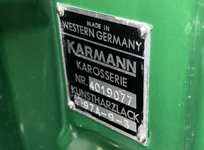

The VIN is in the photo and stacks up with the door jam and the plates in the front of the car and title

wouldnt the numbers on the plate equate to week 40 day day 1 number chassis 77 and 1975?

QUOTE(dt4 @ Jul 27 2020, 11:47 AM) *
the numbers on the plate equate to Year 1974 week 40 day day 1 number chassis 77
This was just after the Karmann body # morphed from WWD95xx to WWD90xx
There should be a black tag in the front trunk with the Karmann # as well. Photo?
What is very strange is the paint code. It should read L97A if the paint was originally diamond silver metallic. The -9-3 I have only seen on the 911's of the period.
