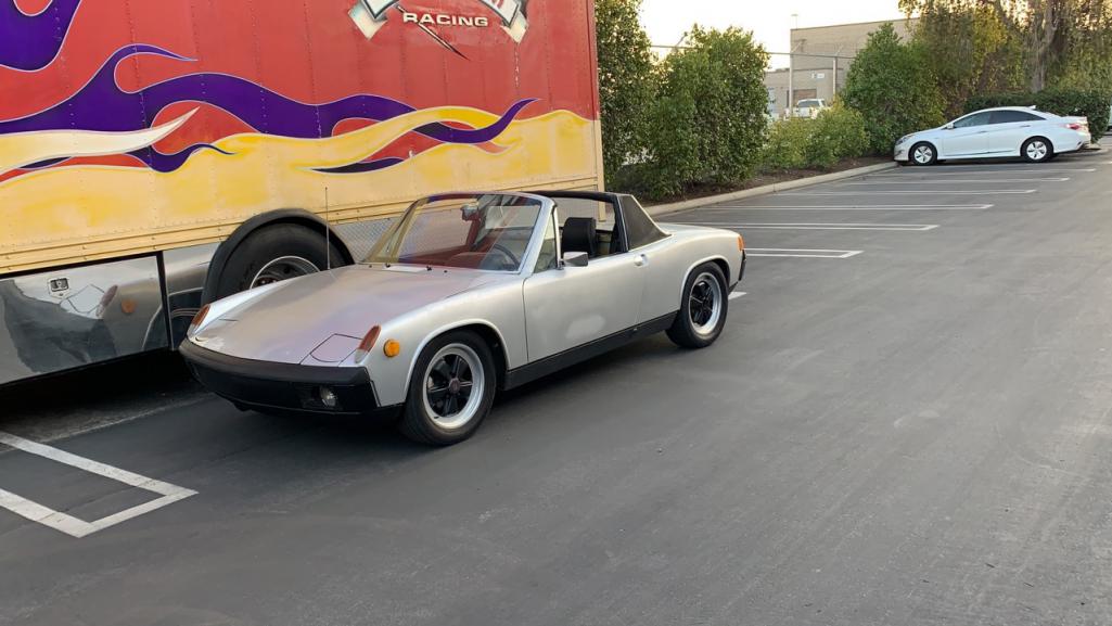

Over the last few years, I have done a few more things to the car. Ill have to add more pictures than this.
But due to the leaking window I had to repair the floor pan. I took the advice of a local metal guy who honestly could have been more helpful.
Really I would have been better off doing it my way and in the future I may revisit my repair. Only the passenger side was affected so that was nice.
I also have re carpeted the car, Need to do the seats and dash.
I also removed the back pad, put in two layers of sound insulation and a felt GT style firewall cover. I prefer it to the padded back pad, it seems no louder but the car feels more roomy.
Earlier I mentioned I had a opportunity to buy a full carrera Front end so i did.
I ultimately sold the brake calipers off of it and replaced them with some Early S calipers I had PMB restore for me with new shocks/bearings/ rotors/ball joints/ bushings and powder coat.
I am however thinking about going to a boxster set of brakes as Im not sure how I feel about these S calipers.
I also finished a full 5 lug conversion with a 911 parking brake because I was tired of the parking brake on the car just being not very modern feeling or modern functioning. this could be a load of things such as venting clearance or how the rear calipers were rebuilt (Did them at home) But i was over it and I wanted more brakes because I knew where this ultimately was going.
I now have the pmb recommended 108mm "System" with 911 parts everywhere.
Motor has been running great, I added a under deck rear cooler, Ill post pictures of that soon. Trans continues to shift perfectly.
And I have been running the wheels I bought from 0396, Gotta say I miss Peter.
I repainted the roof, and did the trailing arm reinforcement when i changed over to 5 lug.
Also I back dated the bumpers, I absolutely hated those big ugly bumpers.
So the paint is failing its a little disheartening but ok. Here is how it sits as of right now.

colingreene   Over the last few years, I have done a few more th...   Jul 28 2020, 02:37 PM
Cairo94507   Your car is looking good. That's a lot of wor...   Jul 29 2020, 06:34 AM
colingreene   After running the car around a bunch and never bei...   Jan 28 2021, 05:53 PM
