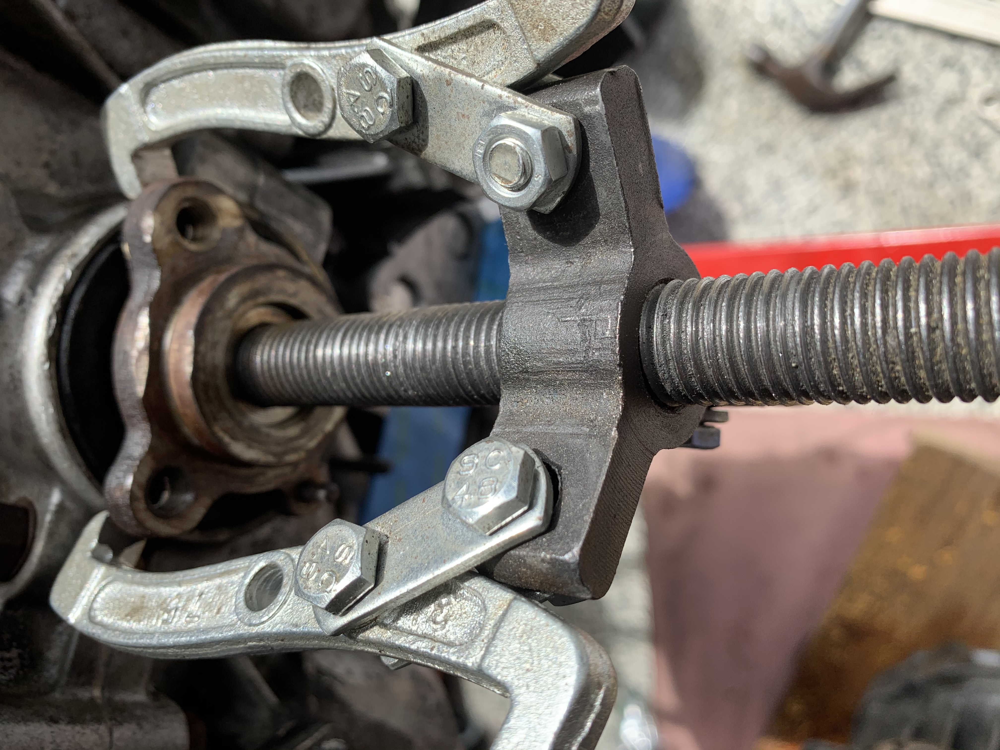

While I wait for the dog teeth to be delivered, I thought I would change the seals (front and rear)
I built a tool for my wheel puller - have turned it to about 80 ft/lbs, kinda worried to crank it another turn,,,,,,
I am using penetrating oil on the shaft,,,,,,,,,what next?
Heat?
Incantations?
Ideas?

Hit it with the mapp torch for 60 sec, hammered around a few times, still on tight,,,
Since heat differential is what we want-yoke vs. shaft, what is the right amount of time to apply mapp?

Superhawk996   Heat. A rap on the side of the hub while it's...   Aug 1 2020, 02:18 PM

pilothyer   If you heat it up with a MAPP torch with it under ...   Aug 1 2020, 03:32 PM

porschetub   No ,penetrating oil will have no effect on a taper...   Aug 1 2020, 04:58 PM

Jake Raby   These can be tough. They are also getting rare to ...   Aug 1 2020, 06:22 PM

cuddy_k   :agree: with the mapp torch. Two things... 1) whe...   Aug 1 2020, 07:13 PM
76-914   You don't need to buy a torch, just a bottle o...   Aug 1 2020, 07:16 PM
bretth   I have not done this yet myself, but when hitting ...   Aug 2 2020, 12:15 AM
Frankvw   I also had the same issue on my type4 2.0L bus eng...   Aug 2 2020, 07:32 AM

sixnotfour   Is the puller going through the bore of the flange...   Aug 2 2020, 09:35 AM
ctc911ctc   I have 6 pullers of various size, this puller has ...   Aug 2 2020, 11:12 AM
sixnotfour   I have 6 pullers of various size, this puller has...   Aug 2 2020, 11:18 AM
Superhawk996   Yowza -- can see deformation of the hub from the h...   Aug 2 2020, 10:18 AM

cuddy_k   At least 5 minutes I would say, but @superhawk996...   Aug 2 2020, 10:56 AM

bobboinski   I have been successful doing this by getting the p...   Aug 2 2020, 11:31 AM
bobboinski   I just looked back at your puller. I use a steerin...   Aug 2 2020, 11:40 AM
ctc911ctc   :shoot2kill: HEAT, MORE HEAT :shoot2kill: W...   Aug 2 2020, 03:38 PM
porschetub   :shoot2kill: HEAT, MORE HEAT :shoot2kill: ...   Aug 2 2020, 05:38 PM
Superhawk996   Well it came off, :Qarl: :cheer:   Aug 3 2020, 06:29 AM
