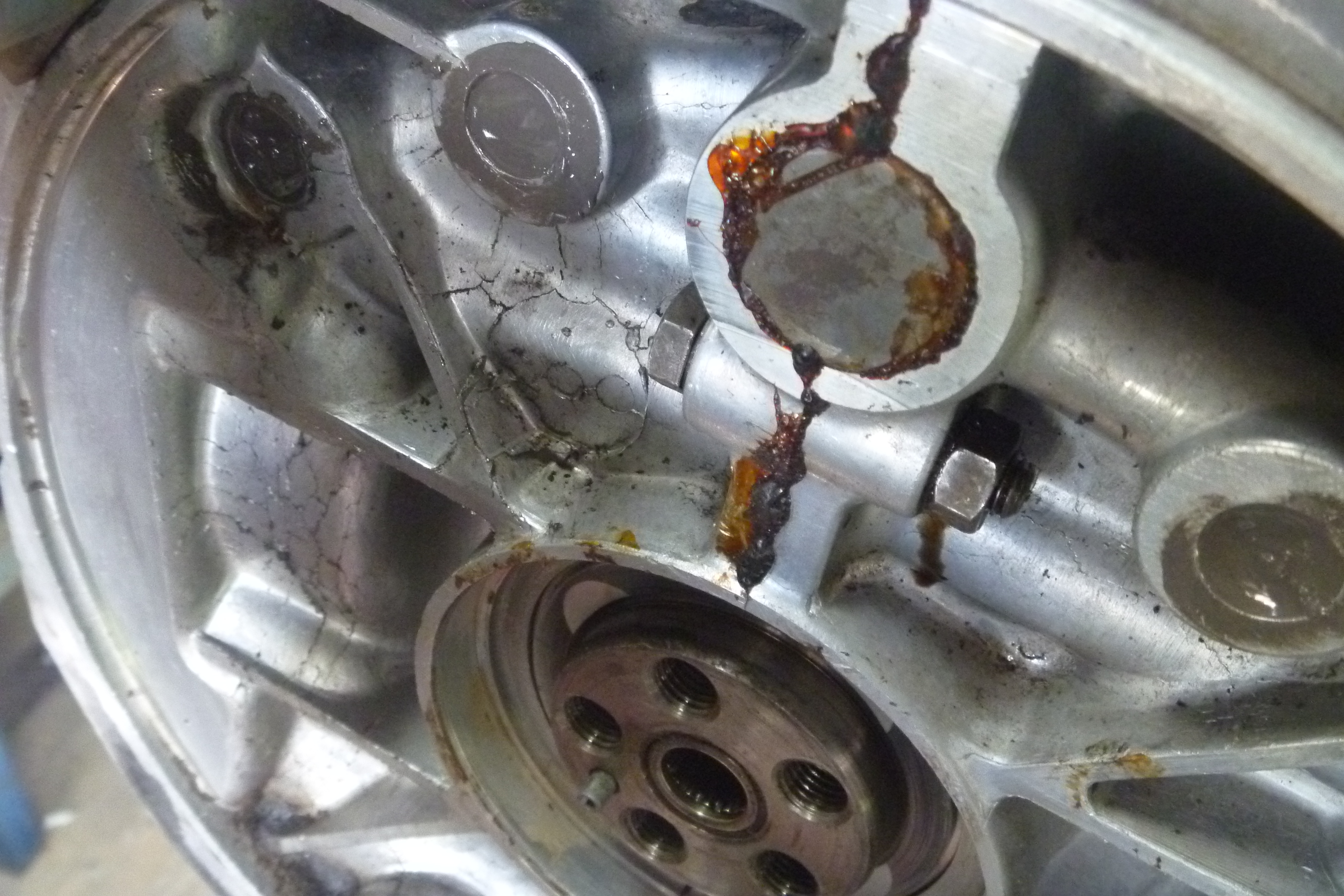

Well it came off, here is the flight path
Seems that it took about 2 minutes of MAPP gas, while the oils burned and the gasket smoldered and then the BANG (as anticipated) with a 4 ft flight path.
The reason is of course rust.
Last, do the galley plugs look good in this picture? I spent an hour cleaning the rear seal and am concerned with the stories of loose plugs
THANK YOU TEENERS!!!!
(IMG:style_emoticons/default/pray.gif) (IMG:style_emoticons/default/pray.gif) (IMG:style_emoticons/default/pray.gif) (IMG:style_emoticons/default/pray.gif)

Heat always works,even better when the part is a taper fit ,big stuff is dangerous ,remember a guy getting his foot broken when a large taper fit coupling popped off with a 60T porta-power in a big way and wasn't retained ,they had to cut his work boot off as the steel cap in his boot had compressed and almost cut some toe's off....scary sh#t.
The oil gallery plugs @ the bellhousing can be JB welded after cleaning and scratching up with course sandpaper if you are concerned about them...I just do it regardless,good luck.
