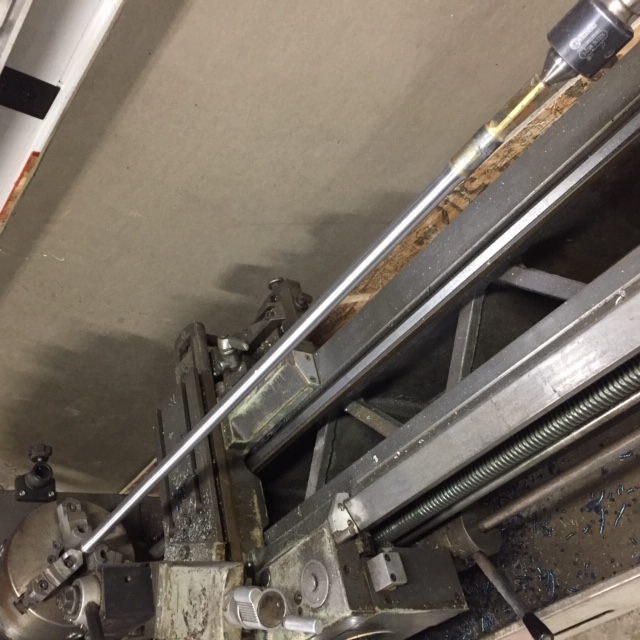

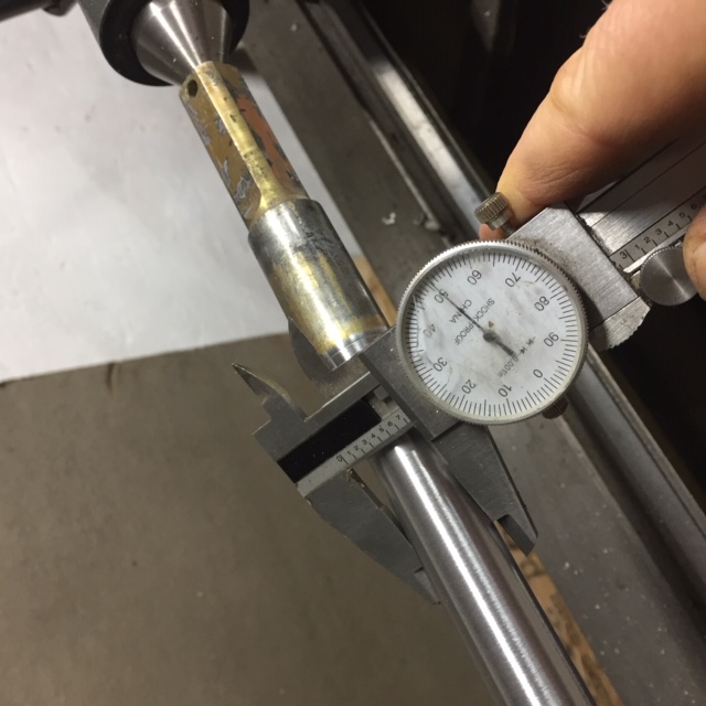

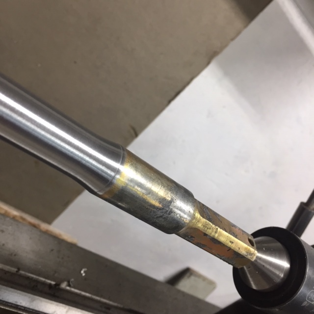

QUOTE(914Toy @ Jul 20 2020, 09:19 AM) *
22m is a lot of anti-role bar for most of our 914's, except perhaps for some serious track set up.
It wasn't easy but I turned it down from 22mm to 19mm. It did make a favorable difference for this street car and if it wasn't so difficult to machine down I would reduce it more but I plan to live with it.
Attached Image Attached ImageAttached Image
