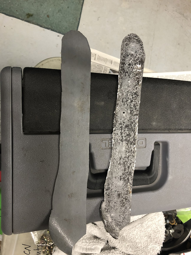

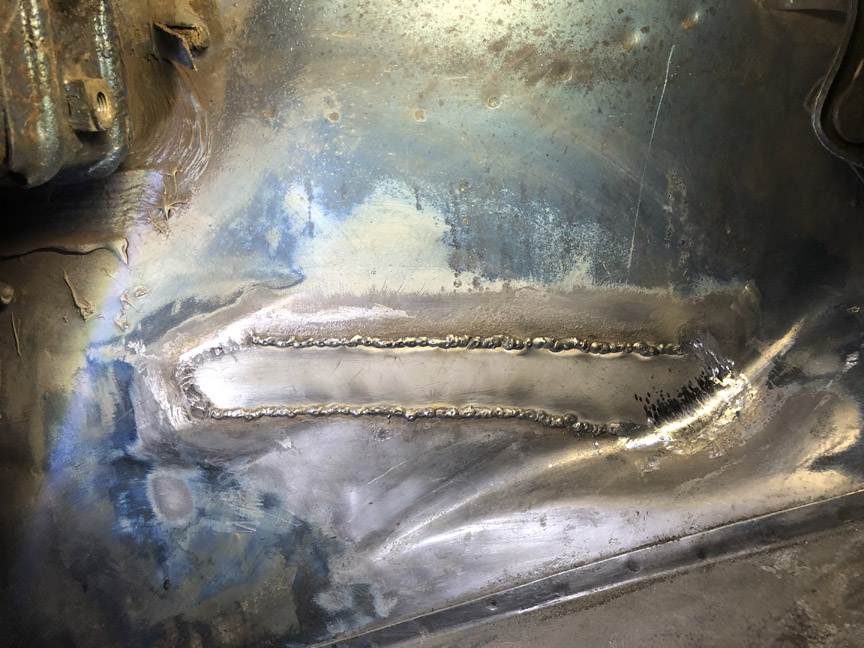

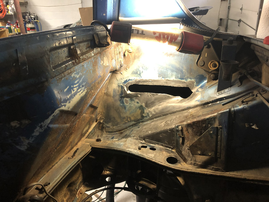

Well, it's been too long, but I finally had a chance to work on the car again today. I was able to remove most of the rust in the battery tray area, but the wall where the tray attaches was just too far gone. So, I cut out the rust, made a patch and welded it in.
Here's the hole:
Here's the patch next to the cut-out piece:
And here's the patch welded in, with some of the grinding done.
Still need to finish grinding and then paint, before I can install the battery tray.
