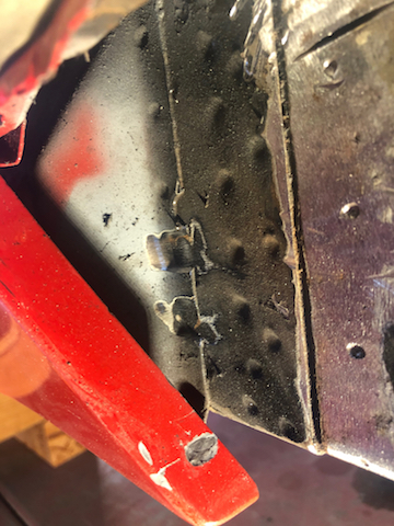

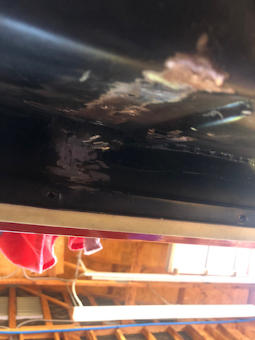

Next up is installing the Brad Mayeur 914LTD Long kit to fix my passenger door gap. It has been very hot here the past couple weeks (in the desert, go figure) so work is going slower than I would like. So far I removed the door sill supports and the jack points and rough fitted the stiffners in place.
Getting to this point wasn't too bad but the jack points proved to be a delicate operation. With the Sheridan kit (soon to be known as 914rubber kit?!) in place, I had limited access to remove them. An extended reach disk grinder, a die grinder, and sawsall made it happen. A small blemish here or there but in general I didn't butcher anything too bad. (IMG:style_emoticons/default/lol-2.gif)
