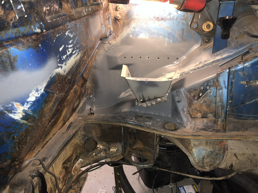

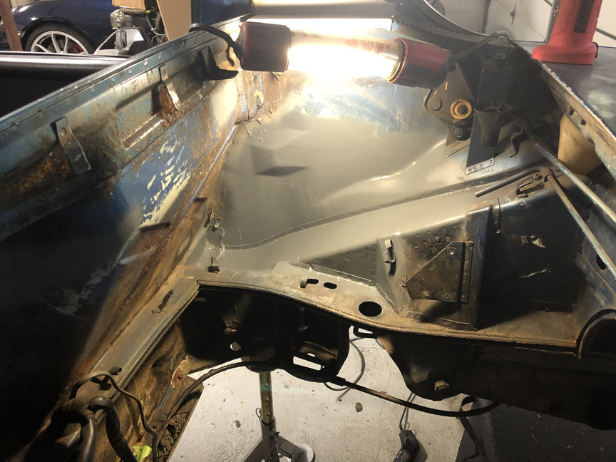

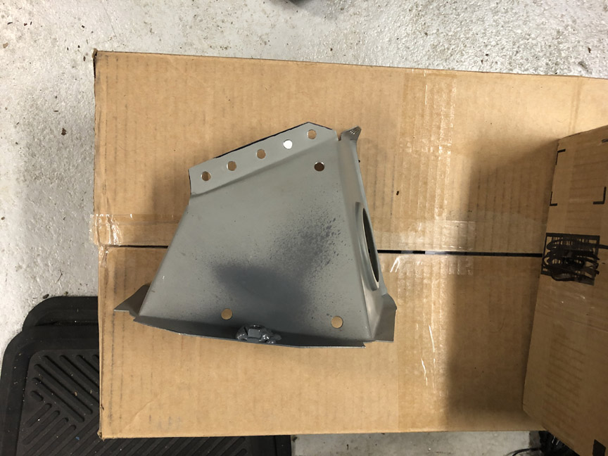

I finished grinding and primed the inner quarter, where the battery tray goes:
Then I welded a nut into the stand and then pre-drilled it, in preparation for welding:

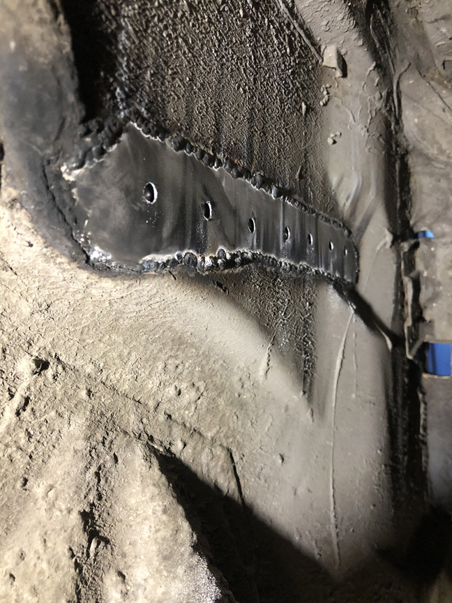

I then welded the stand in place, using the tray as a guide. I also pre-drilled the inner quarter for plug welding the outside edge of the tray.
This is what it looks like inside the quarter panel. It's tight in there, but I can get the mig welder nozzle in and make plug welds

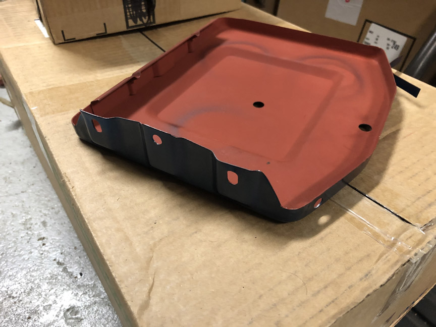

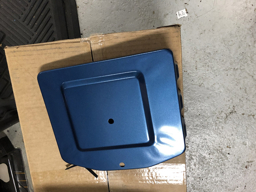

Because it will be such a pain to paint the underside of the tray and inside the stand after the tray is welded in, I pre-painted the tray and inside the stand.

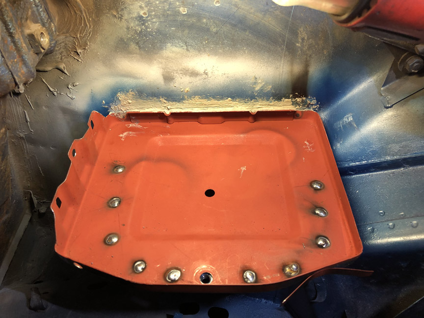

Finally, I welded in the tray.

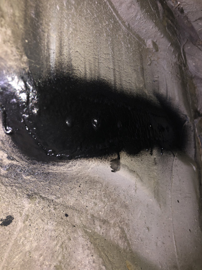

Here's the inside of the quarter panel, after welding and undercoating.
