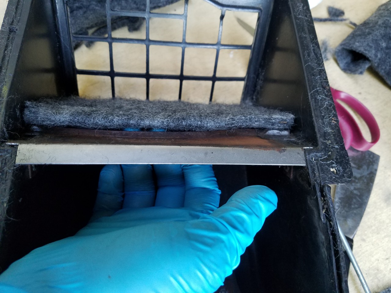

My apologies if this is posted under the wrong topic section. I'm tearing my hair out and stuck. Unfortunately the mustang forums I post to had no replies.
I'm working on my other girl's heater core (91 mustang), and decided to redo all the foam on the blend doors. I saw on the interwebs that older cars supposedly had used 100% wool felt prior to foam becoming the popular material of choice. So I bought some, and stuck it on. Unfortunately the felt is too thick and it's not letting the door make a good seal when closed, see pic below. I have not been able to locate any thinner 100% wool felt. Supposedly the readily available 100% polyester felt found at craft stores will deteriorate after a few years. I also read the open cell foam from the big box stores would also fall apart after a few years. I really do not want to do this job twice. So here I am, with less hair and stuck.
Does anyone have any tips or a source for some felt or foam that would work for this application? Any insight would be greatly appreciated.

Felt that is used for the bottom of furniture legs. Different thickness and it is very dense.
Take a look
