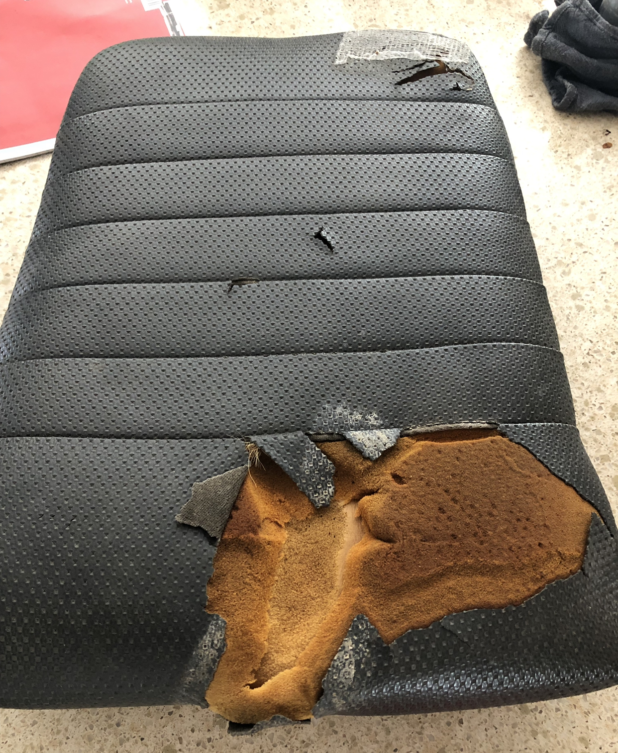

As the title says - is there a tipping point where seat are too far gone to be worth holding on it? I know that you can rebuild just about anything but is there a point where it's just not worth it?
To be more specific - how torn/missing chucks can be bottom seat cushion be and still be usable?

So how about this one as a real example - that foam to my eyes needs repair before being recovered, no?
post Aug 27 2020, 02:26 PM
914-6 GT in waiting
Posts: 19,954
Joined: 19-September 09
Member No.: 10,825
QUOTE(Tdskip @ Aug 27 2020, 04:02 PM) *
Thanks for the discussion.
Mikey sells new foam seat bases or go to the craft store, buy the dense foam and cut with an electric carving knife $15 on ebay/amazon.
Save the seat base board. It has a little metal clip you need and it makes a good pattern to make a new base. Make sure you save the 2 angled wires in the bolsters and the one short straight one in the bottom of the backpad.
I recovered a pair and they came out great. It will take more time than you expect. Always wait twice as long for the contact cement to dry as what's on the directions. Trial fit each part before glue. Gently use a heat gun to remove wrinkles. Do one seat at a time so you can refer back to an assembled one.
