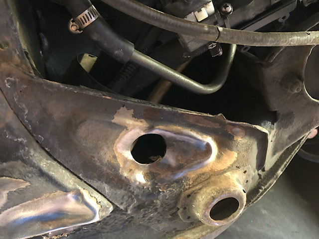

Appreciate the comments on how to keep the hot air out of the cabin. I am going to make sure all the original holes for the heater are sealed (have the block off kit installed but may have missed some). I’ll also duct it to force the air out the wheel well vents.
Back to the long support and question on this brace that supports the jack donut. I have a little ‘while I’m in there’ on my mind and thinking I might as well straighten it out if it isn’t too difficult. Is it just some spot welds around the perimeter or does the donut need to come off separate? I figure it will be easier to straighten out if it is removed. Thoughts? Maybe I should just leave it alone and press...

FL 000   Appreciate the comments on how to keep the hot air...   Aug 29 2020, 02:31 PM
76-914   Looks like the edge of the brace won't move mu...   Aug 29 2020, 04:25 PM
dakotaewing   When I added the Mayer kit for my car I bought a d...   Aug 29 2020, 07:01 PM
tygaboy   When I added the Mayer kit for my car I bought a ...   Aug 29 2020, 07:42 PM
