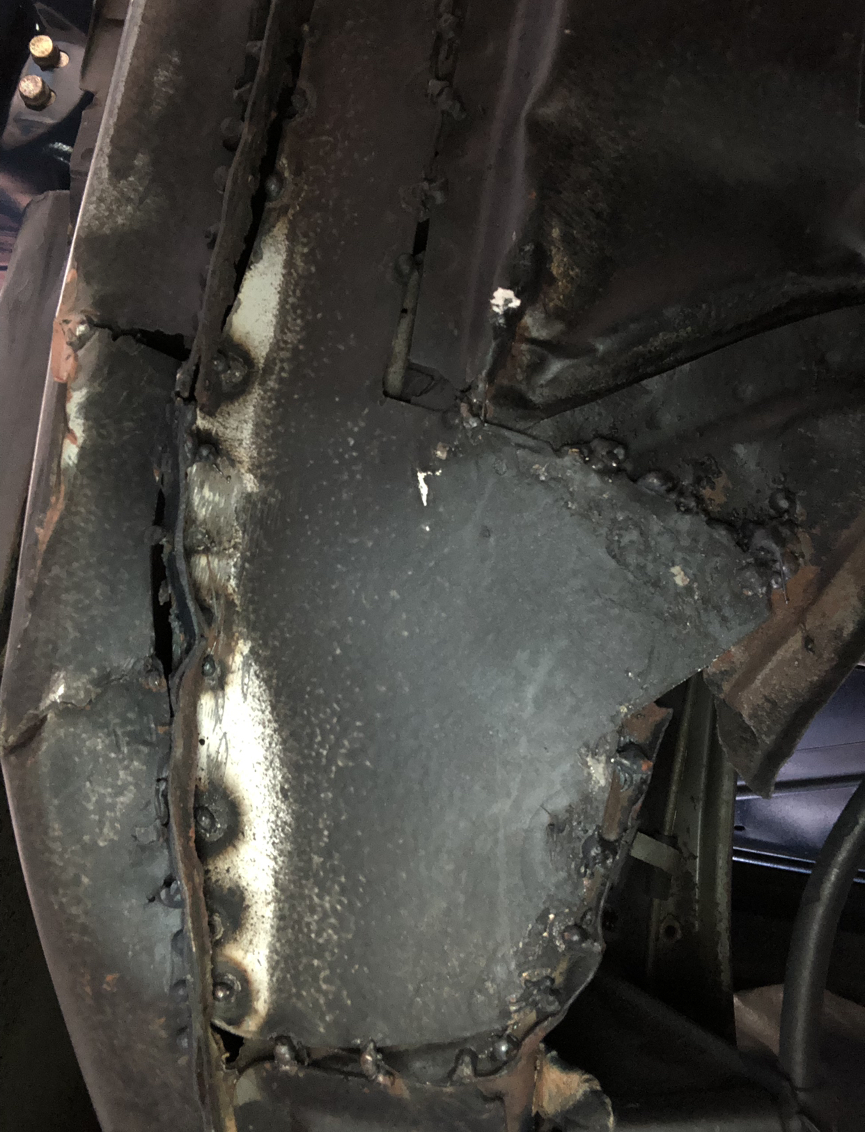

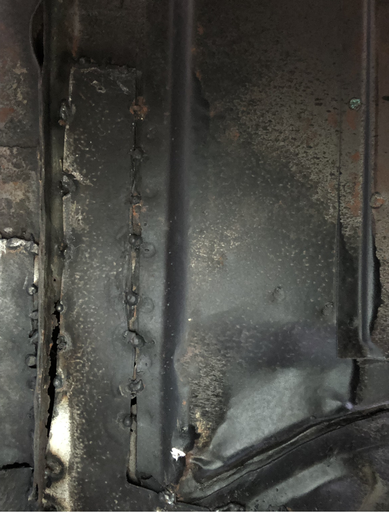

Good morning gentlemen, hope everybody’s having a good week. Just doing some planning here on the blue 74 that is currently in storage. It’s a original Southern California car, been off the road for a very long time but is quite solid except for the passenger side Jack point as shown in the pictures below. Just doing some planning here on the blue 74 that is currently in storage. It’s a original Southern California car, been off the road for a very long time but is quite solid except for the passenger side jack point as shown in the pictures below. There was a repair made here but it’s not to proper standard and I am planning on addressing it. The door gaps are still perfect, so I don’t think the structure overall is weak, this just needs a more proper repair.
I have the donor metal from car that was written off so I think I’m “just” looking at bracing the car to protect my gaps and then getting good weld penetration to complete the repair. Yes/no/maybe?
The paint will have to be touched up of course, and while this is not a visible part of the car if I’m going through this level of effort it would be nice to have it match. It looks like it was a custom paint that I am assuming is going to require me bringing a sample to a shop and then getting as good of a match as possible? Think a good paint shop will be able to get close in match?
Thanks!

Dusting this off now that I have the rear trunk k panel and front patch (were the EV cables went) done.
Here is the section from below;

burton73   I think you should get Restoration Designs Jack Re...   Sep 12 2019, 01:34 PM
Tdskip   Hi Bob, hope you’re having a good day and thanks...   Sep 12 2019, 01:37 PM
burton73   Hi Bob, hope you’re having a good day and thank...   Sep 12 2019, 01:51 PM
johnhora   Tdskip... Why do you want to replace it I stopped...   Sep 12 2019, 02:09 PM
burton73   Tdskip... Why do you want to replace it I stoppe...   Sep 12 2019, 02:27 PM
dr914@autoatlanta.com   be best to replace the jack post and support with ...   Sep 12 2019, 02:36 PM
Superhawk996   . . . . you will have to dent in what you have ...   Sep 12 2019, 06:24 PM
Tdskip   Thanks guys - I thought the key thing here, more t...   Sep 12 2019, 02:38 PM
SirAndy   Am i the only one that immediately thinks "wh...   Sep 12 2019, 02:59 PM
cary   Am i the only one that immediately thinks "w...   Aug 9 2020, 08:17 AM
preach   No. I think I'd have to take that patch off an...   Sep 12 2019, 03:16 PM
bbrock   No. I think I'd have to take that patch off a...   Sep 13 2019, 11:54 AM
Tdskip   As someone guilty of putting a very similar patc...   Sep 13 2019, 05:16 PM
bdstone914   Well then, I'll get right on it! [/quote...   Sep 15 2019, 02:10 PM
Larmo63   I'm not sure if I've EVER used a jack poin...   Sep 12 2019, 05:51 PM
Superhawk996   I'm not sure if I've EVER used a jack poi...   Sep 12 2019, 06:16 PM
Tdskip   Hi guys - thanks for the responses. I'm not c...   Sep 13 2019, 11:30 AM
burton73   Frist, I use the jack post area and a jack post li...   Sep 15 2019, 04:59 PM
Tdskip   Thanks gentlemen, agree this is very important to ...   Sep 16 2019, 06:30 AM
Tdskip   Good morning, dusting this thread off as I am goin...   Aug 9 2020, 06:25 AM
Lilchopshop   Good morning, dusting this thread off as I am goi...   Aug 30 2020, 11:46 AM
Tdskip   Probably not what you want to see, but this is ...   Sep 1 2020, 12:24 PM
Superhawk996   @tdskip :D How timely. We are both going to go...   Aug 9 2020, 08:11 AM
Tdskip   Good morning. Looks like much the same access issu...   Aug 9 2020, 08:22 AM
cary   Yes the Mig can go in from the fender well. But yo...   Aug 9 2020, 08:49 AM
Superhawk996   Yes the Mig can go in from the fender well. But y...   Aug 9 2020, 09:01 AM
cary   https://store.cyberweld.com/miwe26.html It's ...   Aug 9 2020, 09:08 AM
bbrock   I did have to deal with it but I had a lot of rust...   Aug 9 2020, 09:11 AM
cary   Ditto on Brent's comment. The simple method is...   Aug 9 2020, 09:15 AM
Tdskip   Thanks for the discussion and thoughts, will start...   Aug 9 2020, 06:33 PM
bkrantz   One minor suggestion: drill a second drain hole in...   Aug 9 2020, 08:19 PM

Tdskip   Original damage the PO was trying to repair;   Aug 29 2020, 03:12 PM
Tdskip   Door gap is good still however;   Aug 29 2020, 03:32 PM
