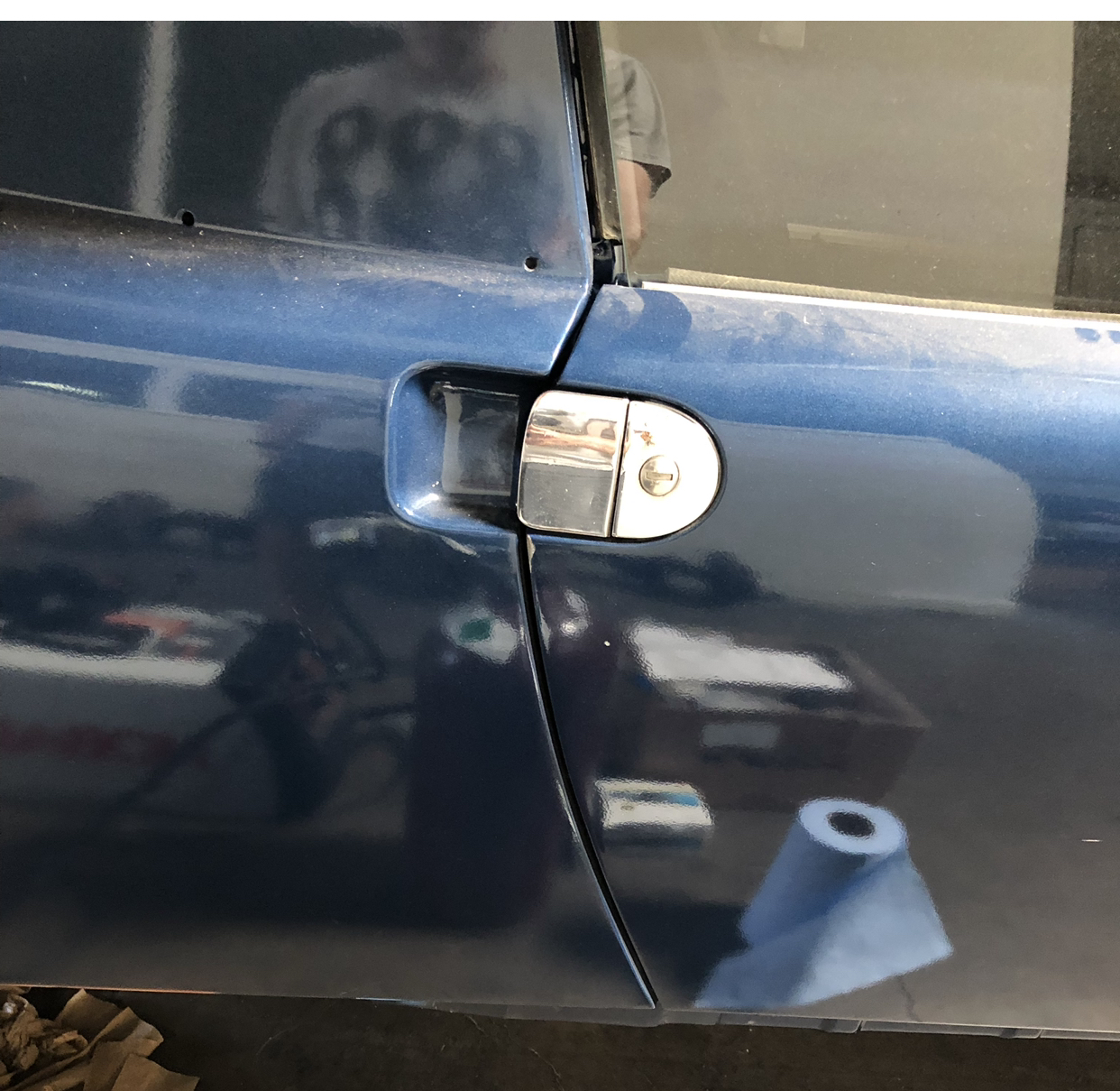

Door gap is good still however;

Tdskip   Door gap is good still however;   Aug 29 2020, 03:32 PM
