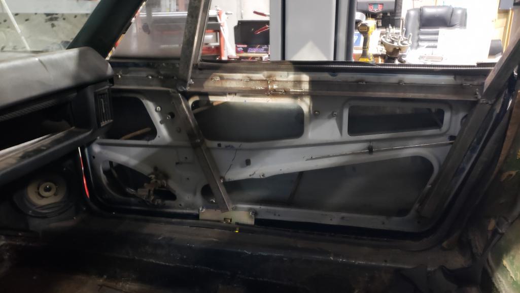

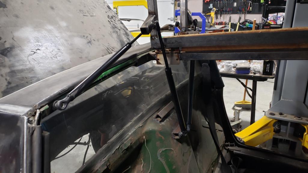

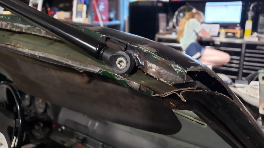

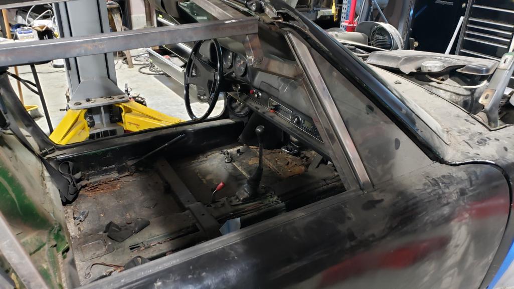

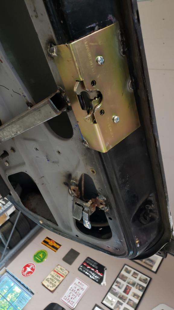

Ok for the Gullwing Update. Here are the steps.
1: Remove targa top and cut in half.
2: weld in doors support bars from front windshield frame to rear roof to hold doors.
3: remove oem doors from hinges
4: build a metal skeleton and attach to door.
5: connect and shape accordingly to allow door to freely swing up.
6: attach hinges to door support bars
7: test out 18 gas shocks for lift characteristics. Goal is to have the door be neutral or weightless at every angle. 2x46104 and 1x4699 for each door should do the trick.
8: weld in supports on center tunnel to hold the 3rd (4699) shock
9: add bracing until door does not flex.
10: weld in new lock mechanism on base of door and a striker on the door sill.
11. relocate the internal door handle the external latch still works fine.
12: I will add to these as I continue to build them out... each door takes about 4 hours to get to this point.
