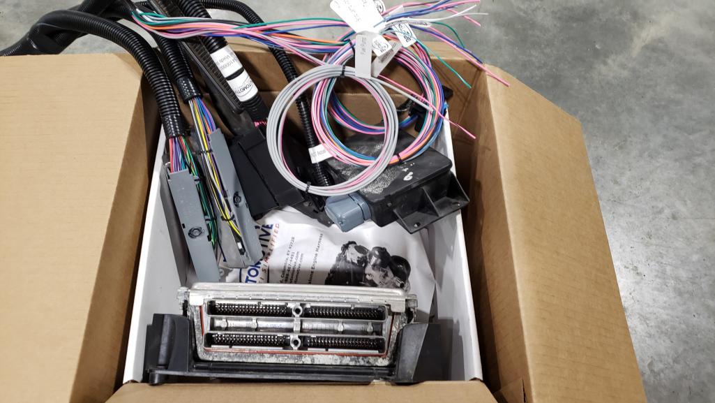

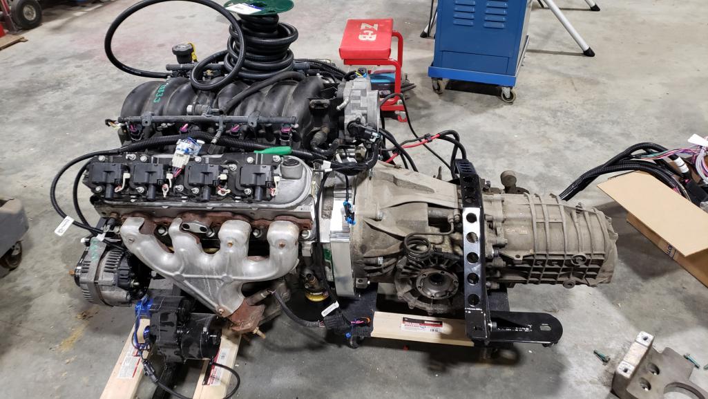

It ran and drove but needed some TLC. I googled for a day or so and decided I would buy a LS6 from a 2004 z06 vette. I called the team at Renegade and bought a starter package to get me moving. LS6 with boxsterS 6 speed and lots of conversion goodies.

Working on getting the engine installed and test fired. Redoing all fuel lines next. Got the tank out (which looks very clean - inside and out)
This weekend my friend Don reprogrammed the LS6 ecu. I wanted the VATS removed but he insisted that about 30 other items needed to be corrected to allow this engine to run. Very cool to see what he is capable of doing. I plan on taking the car there and having him re-tune it on the dyno once everything is installed and the car is drive-able or dynoable.

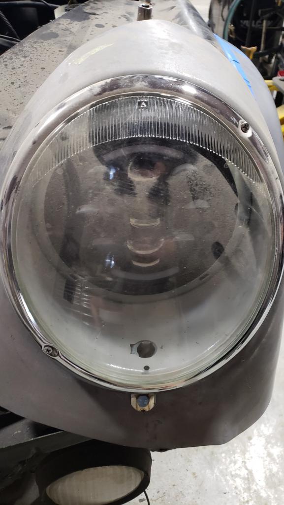

Adding a sneak peek of my next upgrade. 914 pop-up to 911 led headlights... if people don't yell at me for the gull-wing doors this might push a few over the edge to say something. If anyone needs a complete working headlight setup with trim and motors just let me know. I plan on listing them this week.
