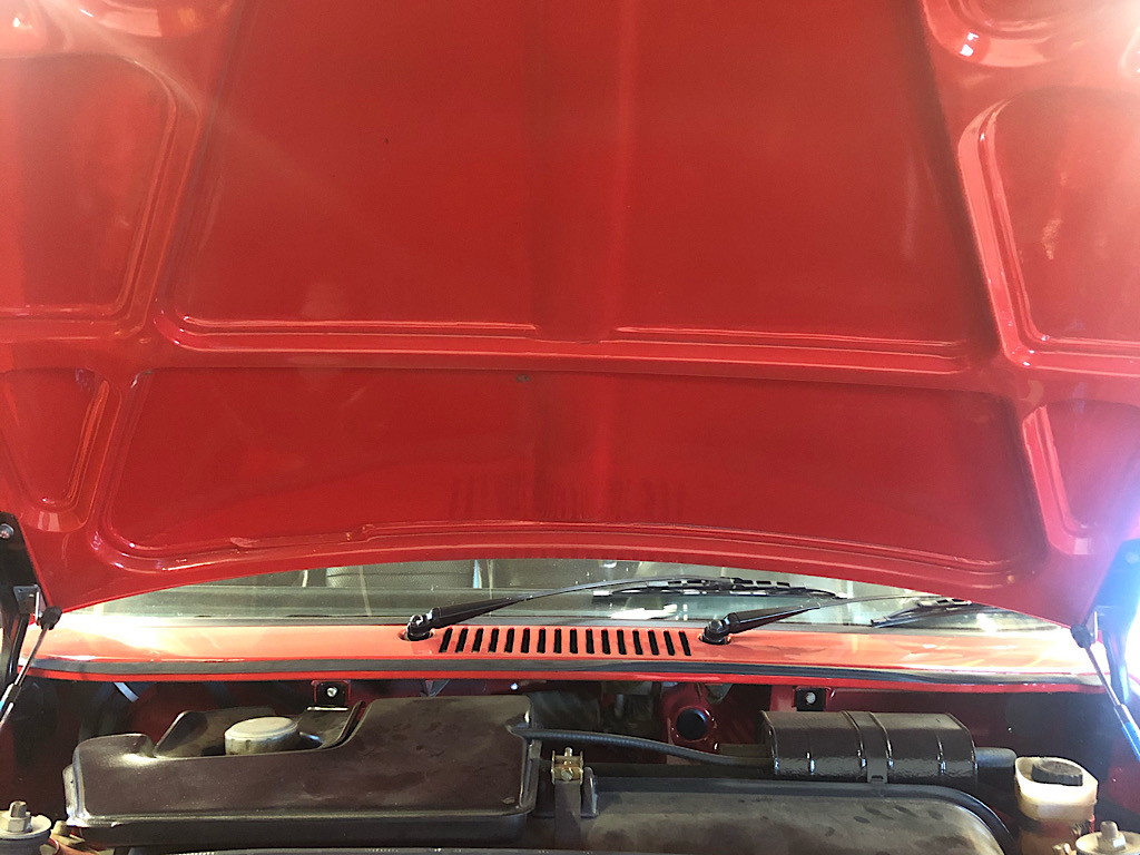

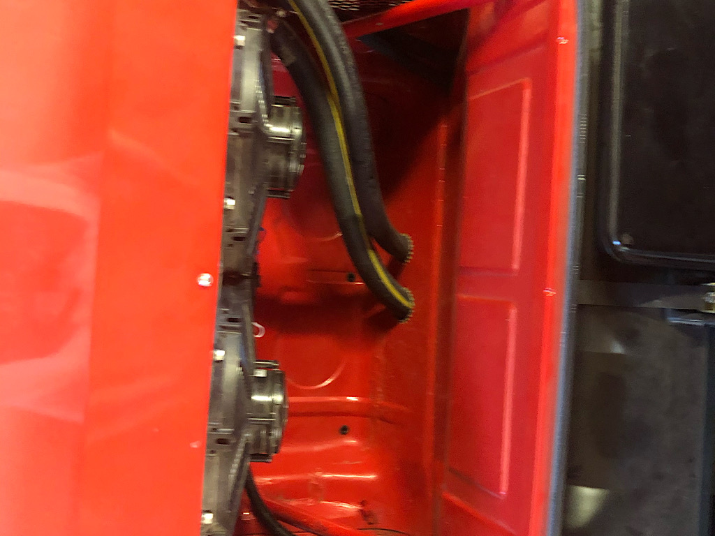

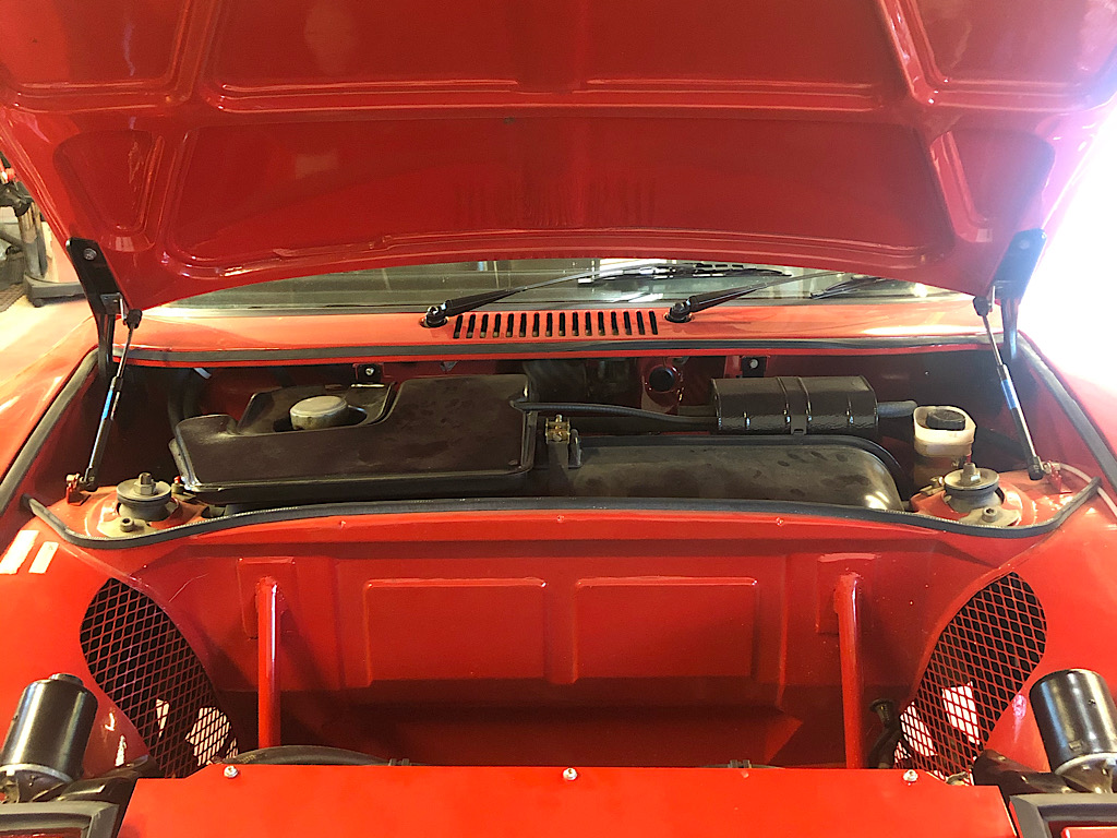

Been a few months since I have done much work but I have been having fun driving! A/C seems to be working well but may need a few more tweaks down the road. Went on a long road trip last month and the cab got heat soaked; AC was still blowing cold but it was getting hot inside. If anyone has any ideas I am open ears, and I am thinking a couple of things may help:
1) I need to make a panel to seal off the opening between my radiator and forward bulkhead in front of the gas tank so the hot air only escapes through the cutouts by the tires. Relying on my fiberglass hood to do that job isn't working well, especially at speed when the increased pressure is pushing the hood up.
2) Additional thermo mat in the cab couldn't hurt. I have a decent amount on the floors, the front/rear firewall, and inside the doors. I forgot to put some under the targa top.

I am starting to try and figure this out for my V8 car and I am curious about the hood and the pressure. I am thinking of having a decorative cover made for the firewall and gas tank and have some thermal protection added in it. Can you post some photos of the inside of the fiberglass hood and let me know where it is pushing up?

Sure thing @Matty900 , I have noticed while driving around the pressure forces the air up over the bulkhead in front of the gas tank. Fiberglass never fits as well as the stock steel hood right? So I realized during reassembly after paint that the factory bulkhead seal was too tall. Nothing a little trimming couldn’t fix, but yours my fit better with that in mind.
The channel running left/right is letting air through, and more at speed.
My plan is to seal off this top planform area best I can, and use a thermal blanket on the front of the bulkhead and underside of cover.
