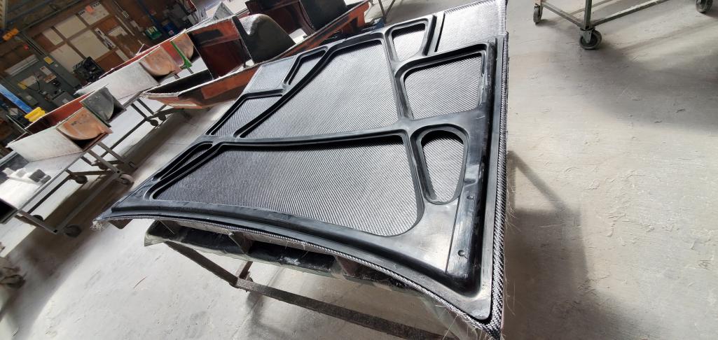

We got the 1st set of Carbon fiber parts done but realized that I need to get the GT hood pins. We are working on the balsa wood reinforcement that will go on these. The weight savings is drastic but don't think that I really need that with 400+ hp.

Matty900   We got the 1st set of Carbon fiber parts done but ...   Sep 1 2020, 12:01 PM
FL 000   We got the 1st set of Carbon fiber parts done but...   Sep 6 2020, 01:21 PM
