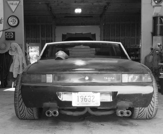

So this 914 project started as a desire to build a kit car, something with a v8 but small and light and crazy lambo doors with big brakes and a manual transmission. After seeing how much work it takes I decided to shortcut the complete car fab process. I really wanted to have more of a creative side to fabricating parts and really having fun but not start from scratch. A local friend had a few 914's and was willing to sell me one that needed a lot of work.
It ran and drove but needed some TLC. I googled for a day or so and decided I would buy a LS6 from a 2004 z06 vette. I called the team at Renegade and bought a starter package to get me moving. LS6 with boxsterS 6 speed and lots of conversion goodies.
I started fabbing up the gullwing doors while I waited for the parts to arrive. Yes I said gullwing doors, or frakengullwingdoors. I know people may not like it but they work and I had fun so far. I will slowly add some progress pics and document the process. I am sure I will have a few questions and welcome any tips or suggestions.
Here is the part of the build....
enjoy
