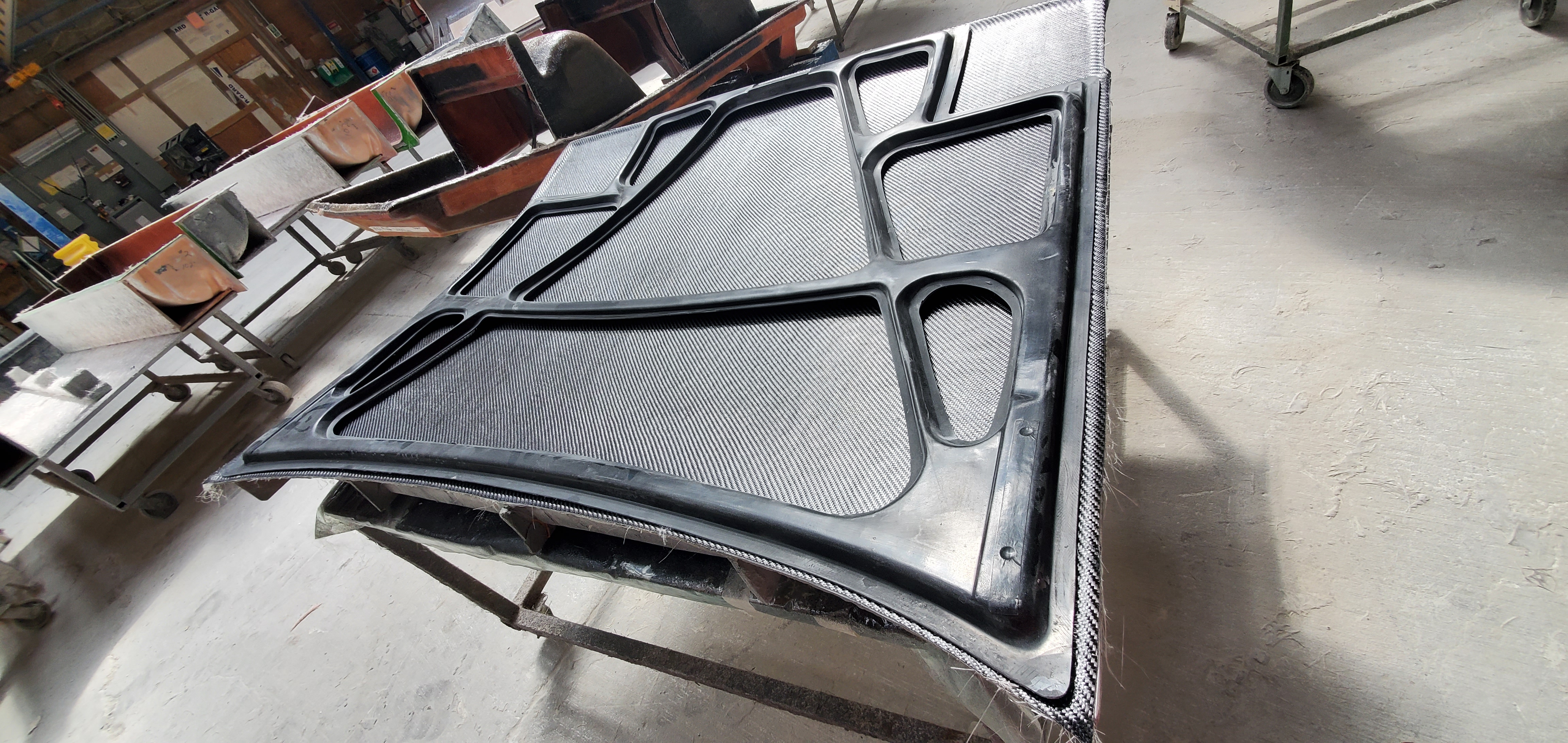

We got the 1st set of Carbon fiber parts done but realized that I need to get the GT hood pins. We are working on the balsa wood reinforcement that will go on these. The weight savings is drastic but don't think that I really need that with 400+ hp.

QUOTE(Matty900 @ Sep 1 2020, 11:01 AM) *
Wow that sure looks nice. Would have to seriously consider leaving the underside as is it I had one of those.
