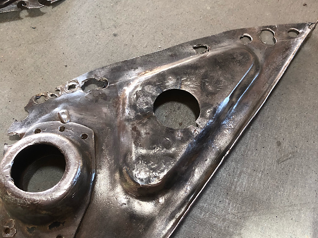

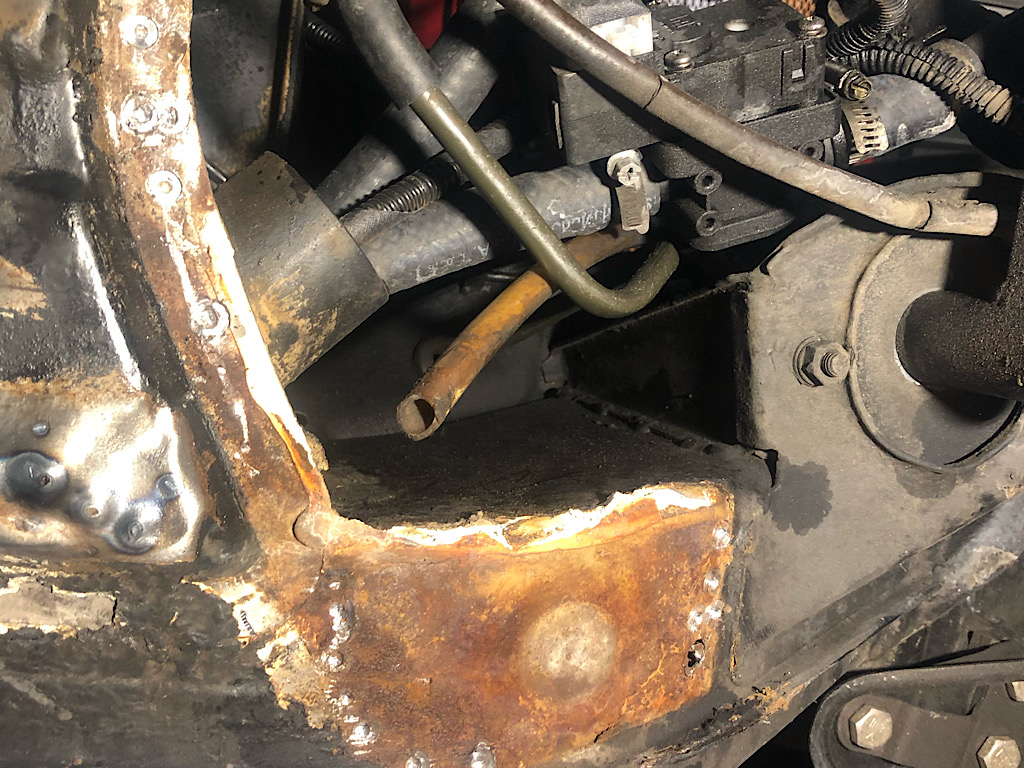

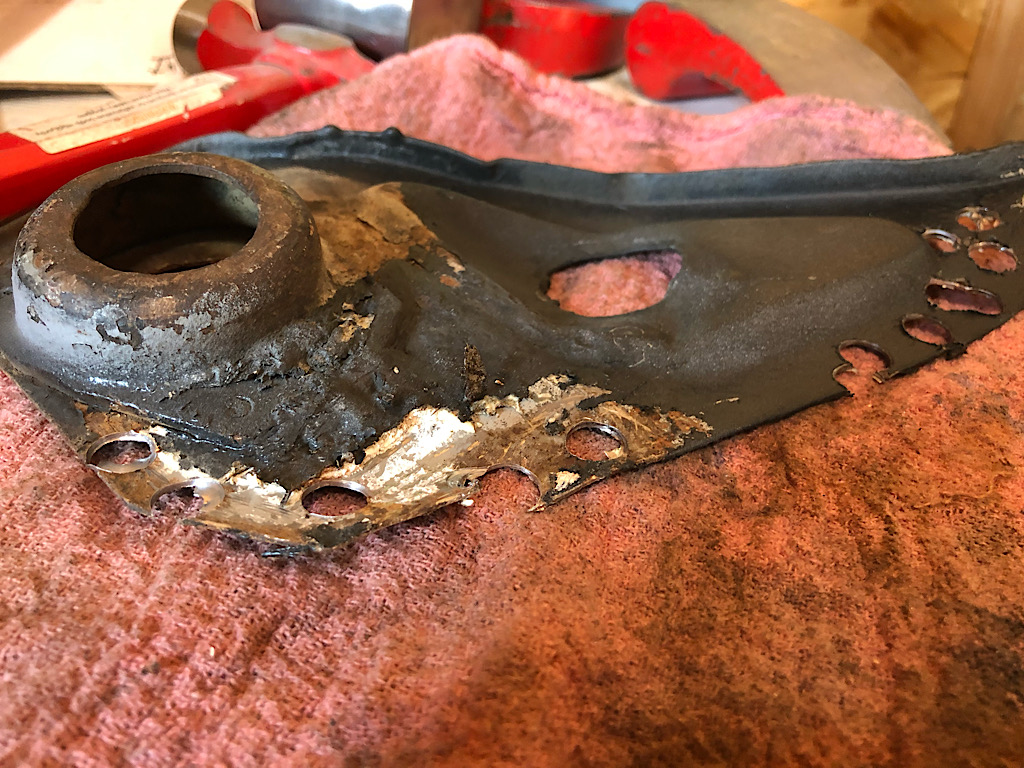

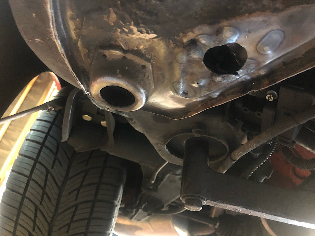

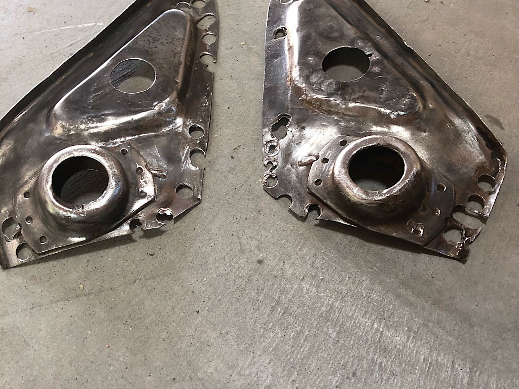

I signed up for the WCR in Nov so time to get some work done. I used my stud welder to try and pull the rear jack support piece back straight. Got it closer but ended up over pulling in a few areas that created raised dimples.
Ended up removing it to hammer and dolly it. Didn’t take as long as I thought it would to remove. On a side note I was surprised how easy it was to straighten a number of areas on the floor pan using a hammer inside the car. I didn’t pay much attention to the underside when I went through the car the first time, but when I am done with this I think it will look pretty straight. A little surface rust underneath but nothing too bad.
I know many of you can walk circles around me with metal work, but I think these turned out well given my skill level for a couple hours work. Here are some before and afters.
Should I fill in with any other of those holes I drilled or just reuse them all for plug welds when reattaching?
