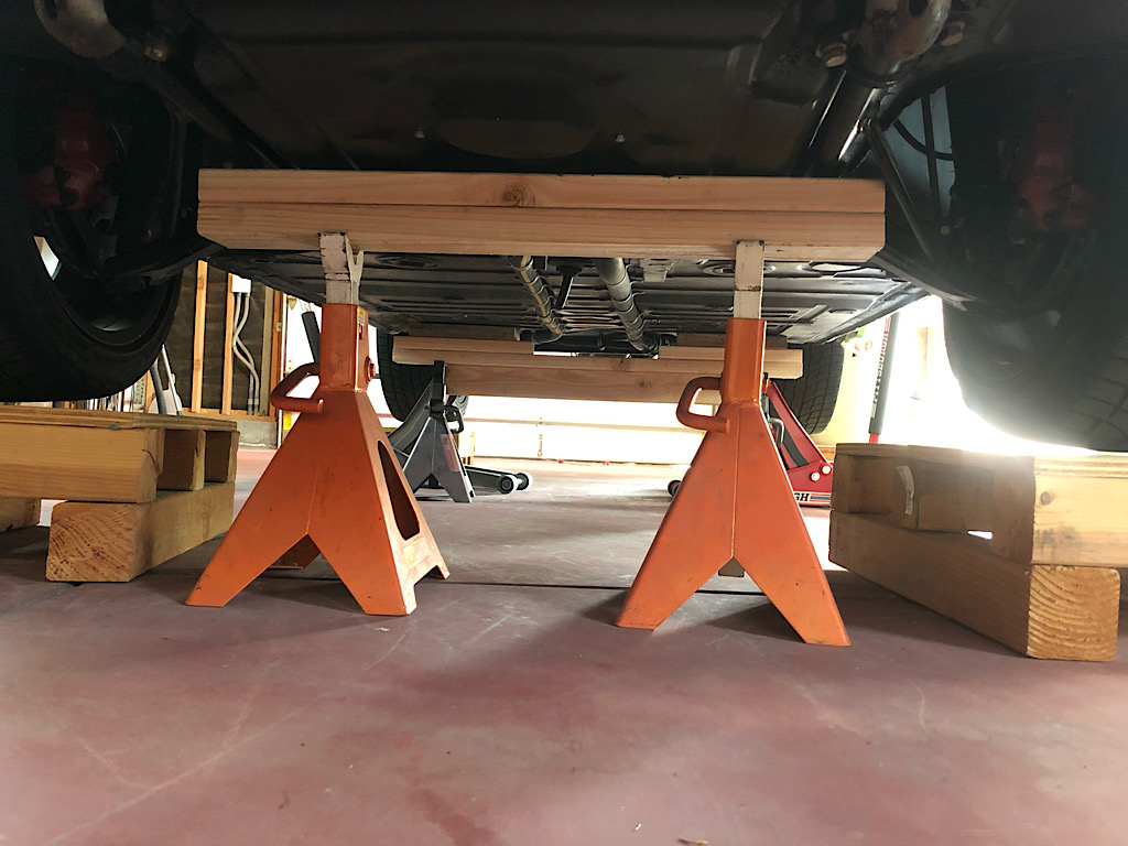

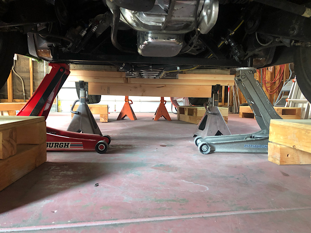

Next up got the car on supports to adjust the door gaps for the long kit. A bit scary having it resting in a couple pieces of lumber and jack stands, but I have other platforms under each wheel in case she decides to fall. I think I’ll limit the time my skull is under the car too.

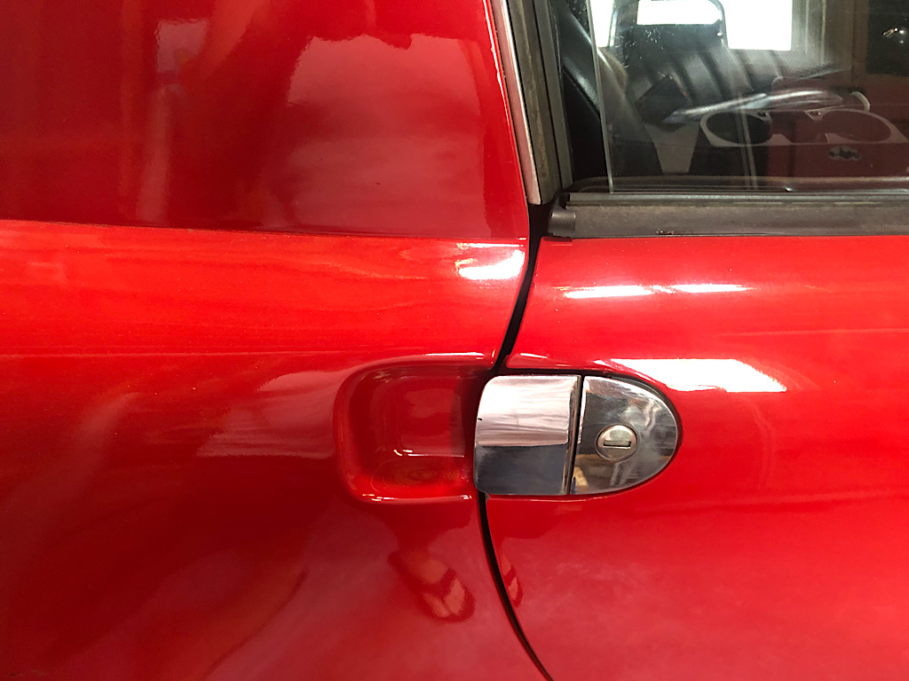

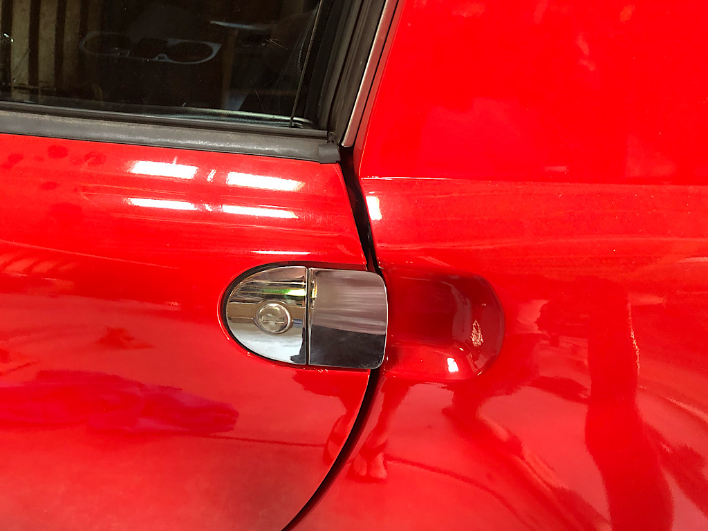

Here are my driver and passenger side door gaps as resting on the supports without anything else supporting the rear:
I’m pretty happy with the passenger door gap as shown here. Driver side will need to be closed up a bit. Calling on @914forme and others - my plan is to weld the passenger side long kit in first since the gap is good, then use a jack under the trans to lift and close the driver side door gap to the right amount before welding in the driver side. My assumption is the passenger side won’t move while doing this. Good assumption or no? I would like to do this with the doors attached so no easy way I am aware of to set both driver/passenger gaps before welding.
