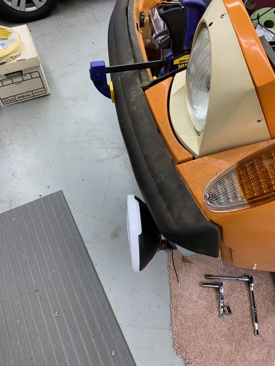

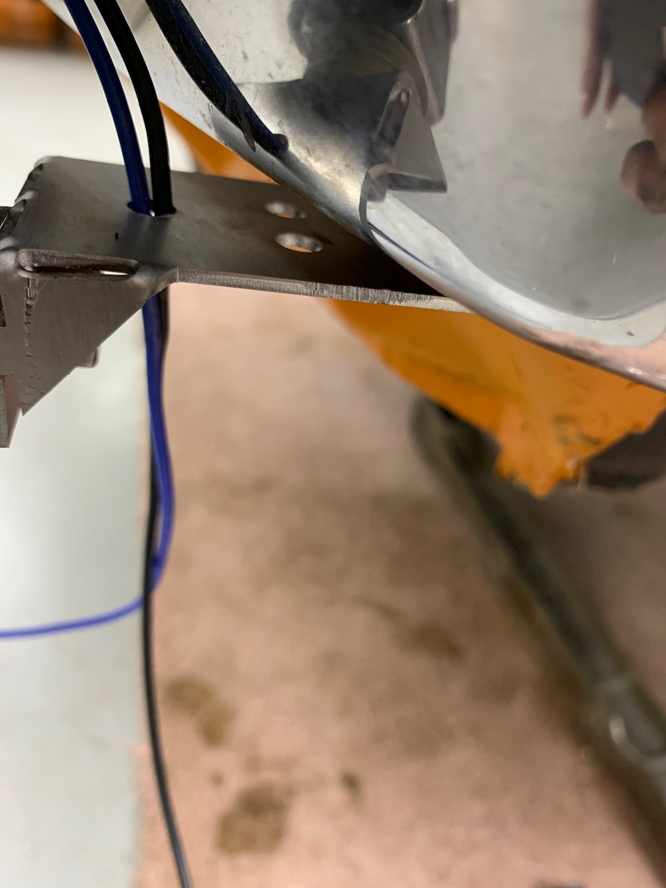

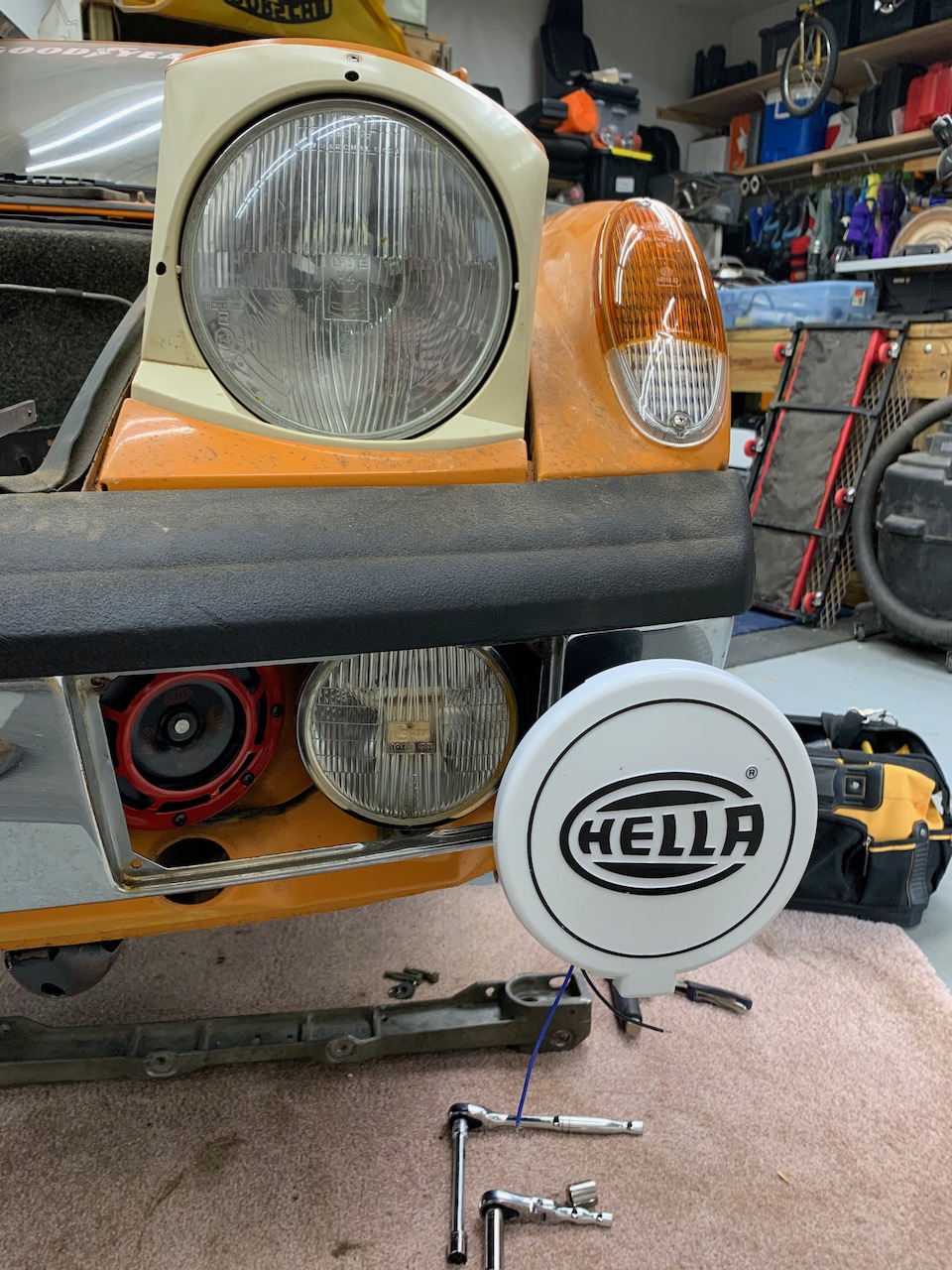

Alpha test unit, this was mocked up, I need to grab a set of Cibi Oscars. That Hella looks out of place with the other lights.
Have a few changes to make. And an idea to make it easier to hold onto the bumper mount to make installation a bit less of a hassle. Right now you need at least 3 hands, in my case, two hands and a leg.
But here it is, the cost will be based of final material choice, an TIG weld time. Lots of little dimes to be added (IMG:style_emoticons/default/blink.gif)
And I found out an interesting item on my -6 the bumper was being held on by friction and gravity. No nuts on the inside of the bracket. That is the reason for the large clamp in the picture.
I added a few holes to allow for better wire management. The hole that the two wires drop into will be upsized for a grommet and the grommets will be included in the kit. There is a set of rear holes that can be used for a zip tie to hold the wires close to the brake to get them behind the bumper.
Also note the Alpha Prototype was made out of mild steel, no welding was done yet. Metal is strong enough to hold the weight with just the physical bends. I will weld it and do a stress test at a latter date to failure.
As I said I have a couple of changes I need to make to the design, and it will be ready for production.
Want to test fitment with a Set of Cibie Oscars, and Cibie LED Oscars. As I think the back space will be different for each.
These can be made out of various metals, I laser cut these.
Mild Steel $$
Stainless Steel $$.$
Titanium $$$ roughly 4x the price, but would be (IMG:style_emoticons/default/drooley.gif)
