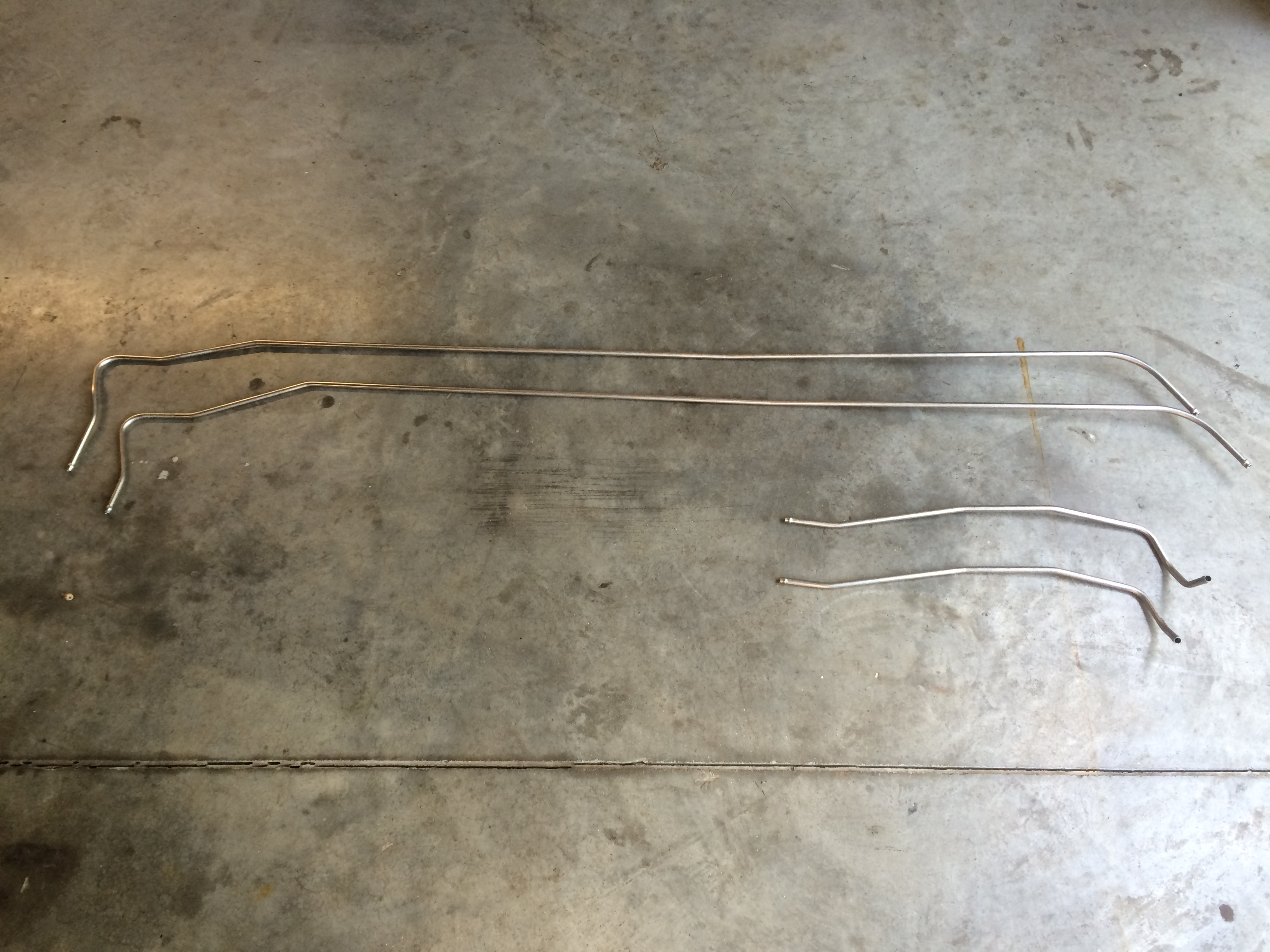

Have OE flexible lines removed. Engine still in car, gas tank out.
Does it matter which fuel line goes where? They all have slightly different bends so I would guess that it matters at least a little bit. I mean I know that the long ones go through the tunnel and the short ones into the engine compartment (duh), but not sure otherwise.
My kit from Tangerine did not have instructions, so looking for any help.

sdoolin   So in my pic, top to bottom first line is feed fro...   Oct 11 2015, 12:03 PM

sdoolin   Thanks for all the replies, long lines are install...   Oct 11 2015, 02:37 PM

sdoolin   I have the long lines and the engine bay lines ins...   Oct 12 2015, 10:55 AM
Racer Chris   The engine lines appear to be reversed, ie the sho...   Oct 12 2015, 12:37 PM
sdoolin   Good to know. I will re-install them when the en...   Oct 12 2015, 01:30 PM
