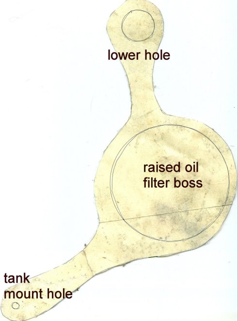

Dan Roots template that I used, set printer at 8.5 X 11"
I found the big holes were a hair off, or at least my hole saw was off. Best to print this out and then check on the tank before cutting.
You also have to cut a hole in the engine tray for the bottom tank return/inlet). I did this by measuring and a bit of dead reckoning.
