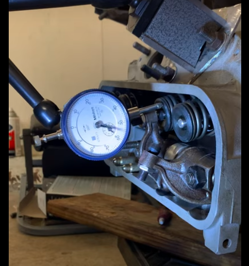

Looking good Jared.
I think I was able to capture the halfway point between the lift and that looks pretty close to spot on. At half lift you want to try to be parallel with the top of the valve to the face of the rocker.
