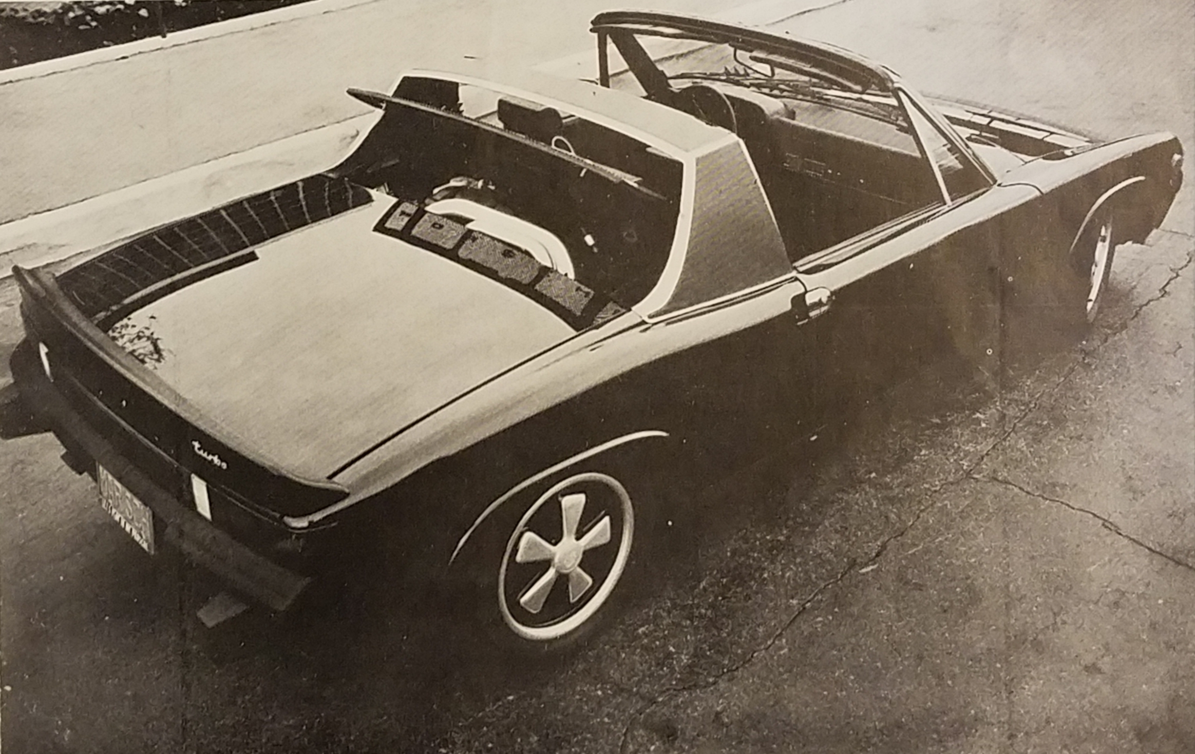

Enough real estate under that lid to stuff a 2.7L turbo sytem in there as well (IMG:style_emoticons/default/smile.gif)
