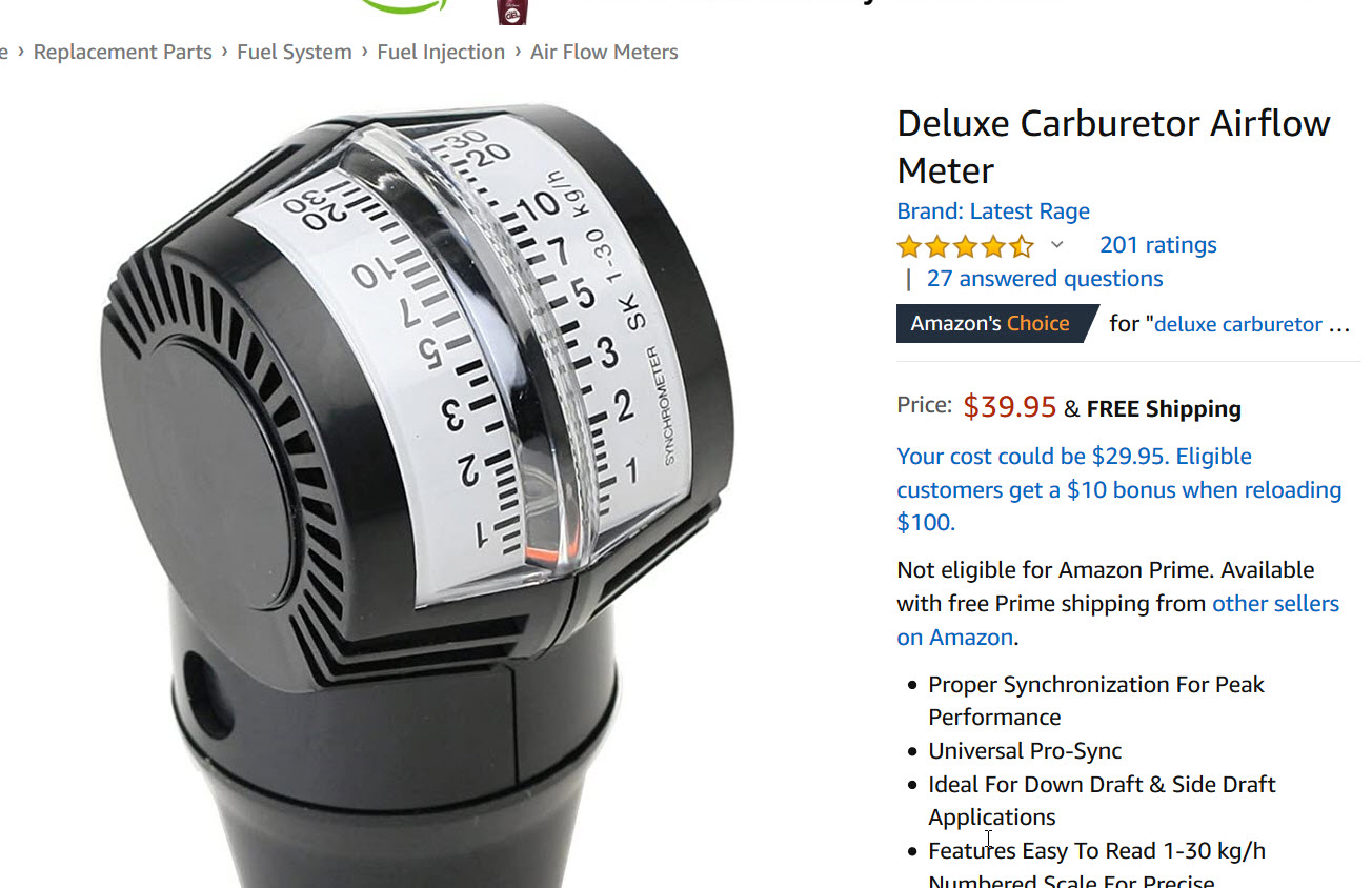

Is this all there is to it? Just test or measure 1 barrel at a time either holding the RPMs steady or just idling?
Mark Henry
post Sep 29 2020, 01:41 PM
that's what I do!
Posts: 20,065
Joined: 27-December 02
From: Port Hope, Ontario
Member No.: 26
QUOTE(malcolm2 @ Sep 29 2020, 12:54 PM) *
I like how Amazon calls this "deluxe" seeing as it's the cheap Chinese copy. (IMG:style_emoticons/default/dry.gif)
The better one is the STE, made in Germany. About $20 more, mine's almost 30 years old.
