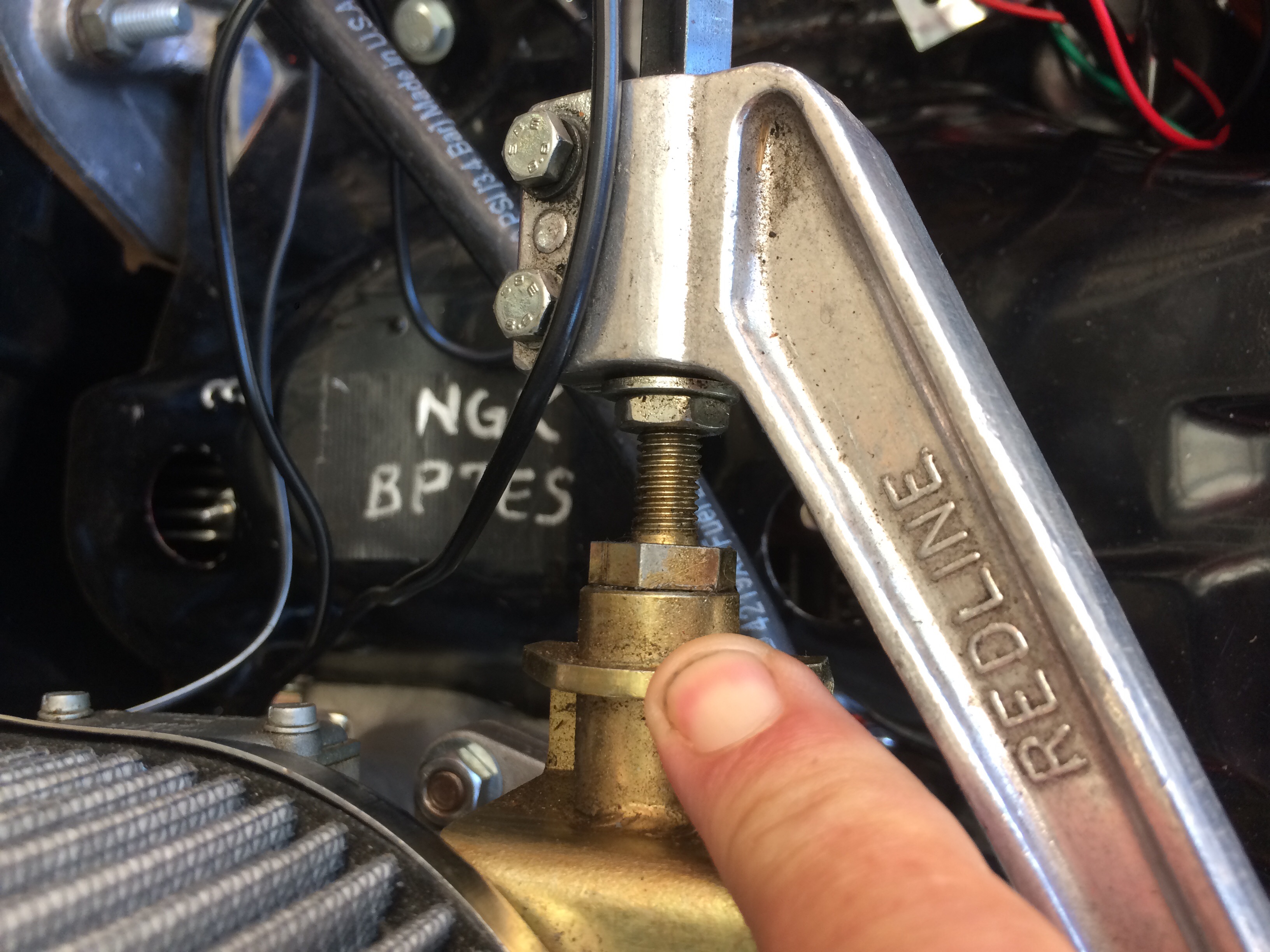

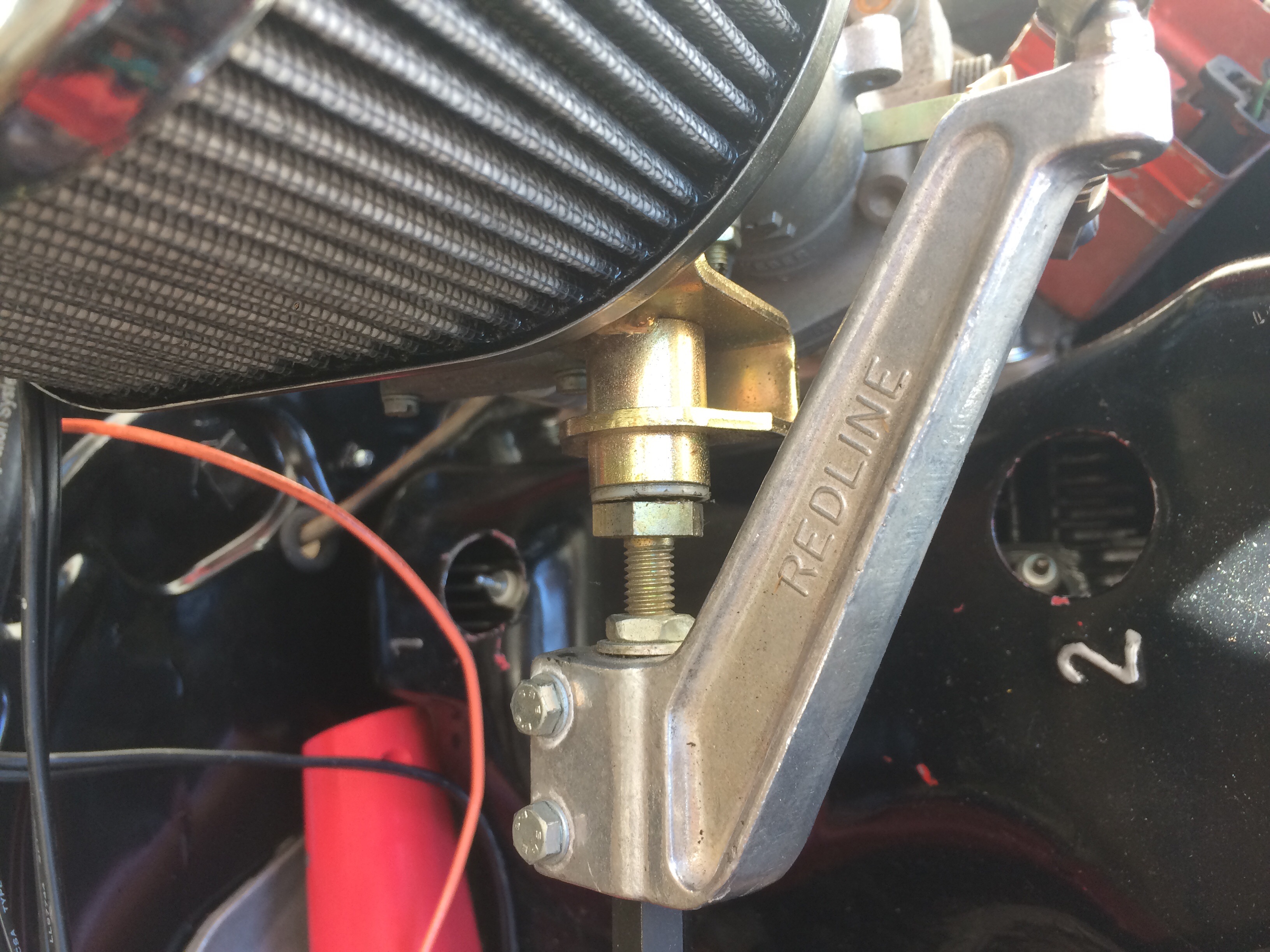

I got the snail version on the way. I just pulled the filter and it looks like the snail one will just fit better. The other type will require taking the filter base off too. and the jets are in the way. I assume those tall brass screws are the jets, right?
Also have some non-metallic plug wires coming. It seems that the flame thrower 3 module requires them.
Removing the carbs tonight and giving them a cleaning. I guess that will be a good time to set up the set screws.
I also found that one bushing on the hex bar is missing.Attached Image
