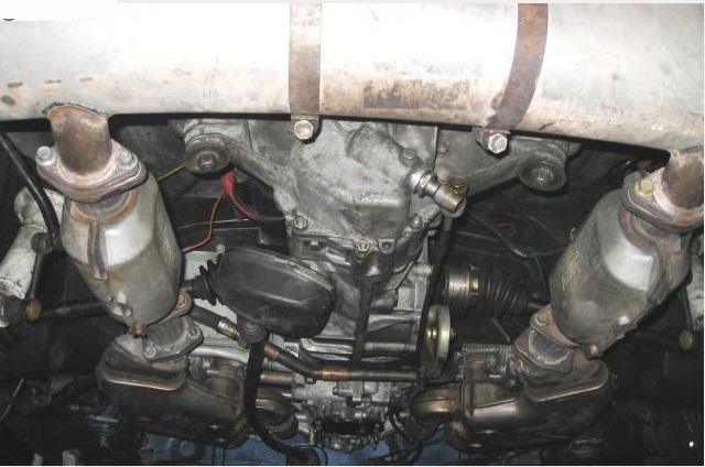

Village Idiot ![]() ![]() ![]() ![]() ![]() Group: Members Posts: 8,930 Joined: 25-May 04 From: About 5NM from Canada Member No.: 2,105 Region Association: Pacific Northwest
The 914-6 conversion I bought uses 993 heater boxes and two high flow Cats. I like it, know it leaves some power on the table, but the 914 doesn't stink.
The CIS is set a bit on the lean side, noticeable only when cold. Looks clean though, the guy did a good job. Attached image(s)
